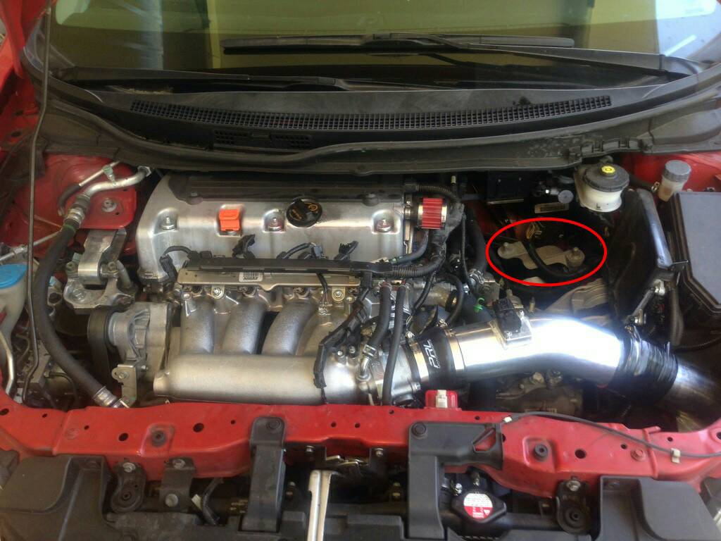

2. This metal bracket circled on your picture below serves no purpose anymore now that you changed your intake. All it does is provide a place for the stock intake box to sit on. Take it out, because it's a big chunk of steel just taking up space and weight.

2) Thanks to you giving me homework once again, I'll be taking that bracket out today.
Did you notice that your metal bar that serves as a hood support when it's open doesn't fit now that the RBC is on? I had to take mine out because it was hitting the manifold.
I had to bend mine slightly to make it fit, others have had to do the same thing too
