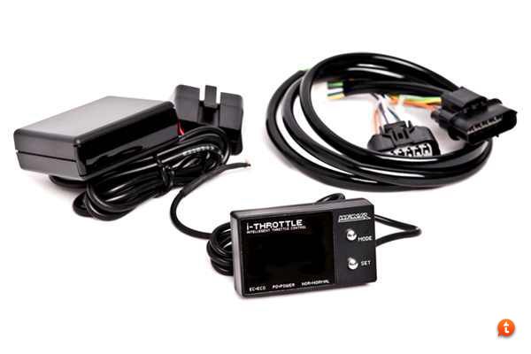

Can't say that I have, if I did I probably just thought the car needed a transmission service or a diff service. have you looked into one of those Throttle control things? It works with the DBW systems. It controls the sensitivity of the pedal.

I've only read up on it a little bit, but I think Blitz,Buddy Club make them. I still have to do some more research for it.
You lost me there. Pedal sensitivity can be changed how? (They used to use spring tension.)
To put it simply, when you press the gas pedal at about 25% of the way the throttle controller will make the computer believe you are pushing it 50% of the way or vice versa. I'm not sure if you can adjust the response of the throttle to be more sluggish though.

Have you ever seen one of these before?
I had one on my previous car. It acts the same way I explained. You have different settings which will adjust the throttle response to be more sluggish or to react quicker. It's kind of redundant because you could do the same thing by just pressing the gas pedal a bit harder than you're used to.
There was nothing mechanical to it though. You can just plug it in and adjust the throttle response live.
