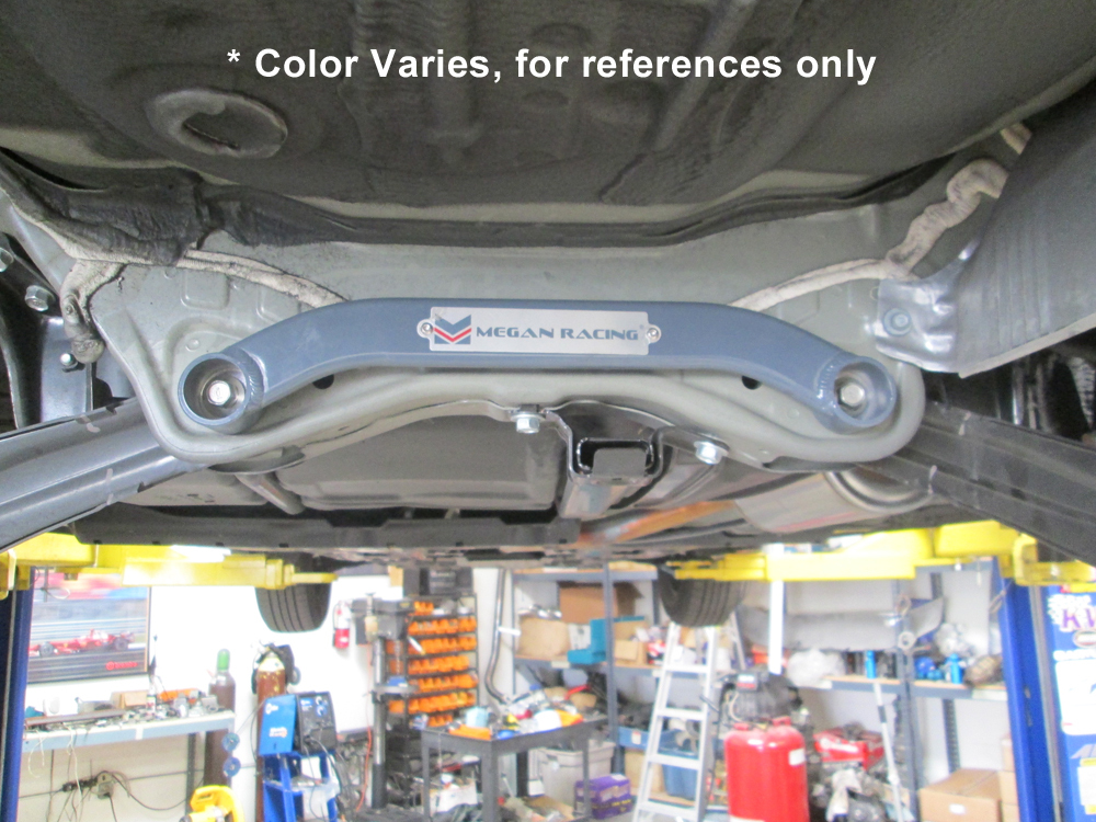

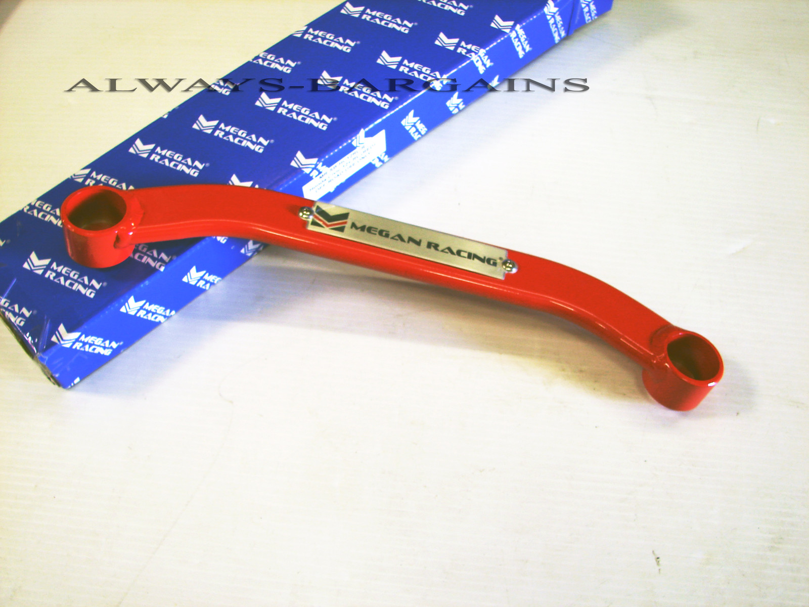

i might get this rear lower tie strut bar later on.

Don't waste your time on the lower brace. It won't do a thing. Look at how much metal is already in that location. It's super stiff as it is. Same with a strut tower bar on these cars. If HPD aint' running one on their race civic, you don't need it either. hahaha.

Yes. Agree. I have the Beeks tie bar and it is only for looks. I'm pretty sure it doesn't give any extra rigidity at all.
