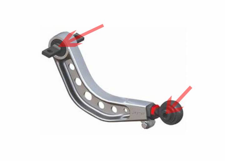

I had the same issue with squeaking in the back, turned out to be the camber arms.
It'll be a little bit of work but grease inside these 2 areas, and it'll go away.

As long as you don't touch the adjustment nuts behind the bottom bushing, no need for an alignment. And I only greased mine once and it's been almost 3 years now without the squeaking.

Silicone spray. It won't be as effective as removing the arm, pulling the c-clips, and removing the upper pin and greasing it. As long as you don't change the length of the arm you can remove and reinstall it without issue. If you don't want to bother any rubber safe spray type lube should work.

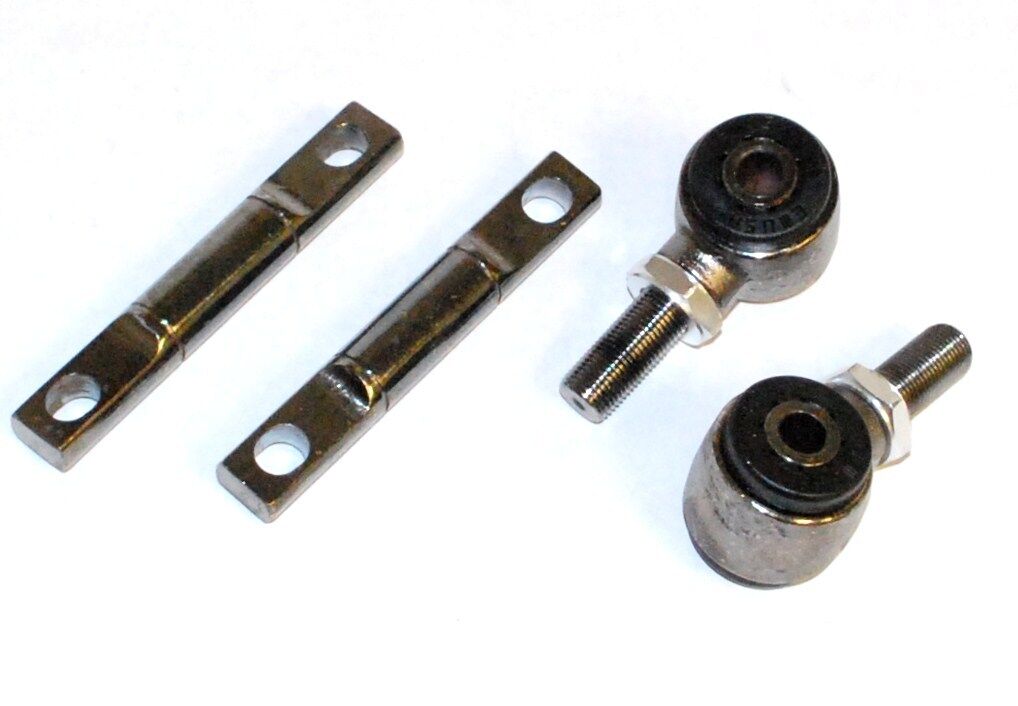

The dealer was probably thinking about the threaded end. Thats a steel insert into an aluminum arm and should have been properly greased before assembly with anti-sieze. If not, they've just become a set it and forget it piece.

If you have a skunk2 or Buddy club style steel/aluminum arm:
This is a long discussion as far as anti-size and mixing multiple metals goes but the "best" anti-size you can get for this particular application, including the threaded ends, is a nickel based A/S compound. You are putting a threaded steel end into an aluminum "arm" in an area that sees a lot of heat, dirt, and moisture.
You should look for either:
Permatex 77134 Nickel Anti-Sieze Lubricant
or 77124
Or a Zinc base. Loctite makes one.
Loctite Zinc Anti-Seize is #39901

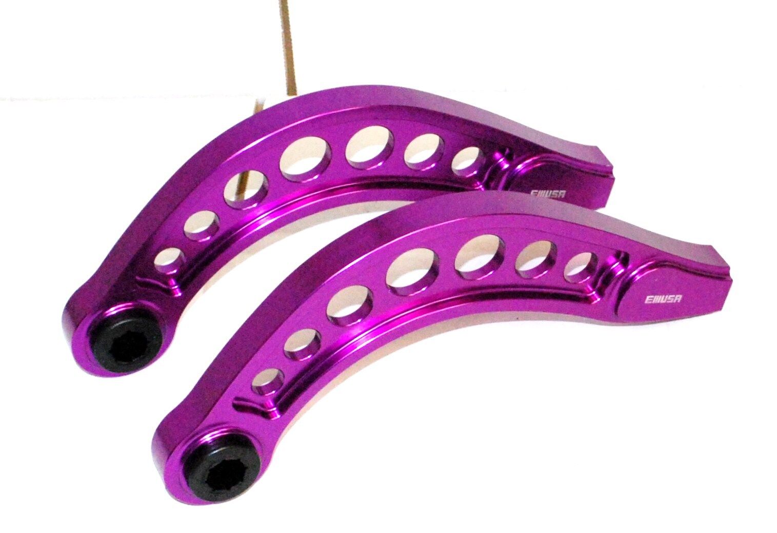

emusa
Yup. Steel insert into aluminum arm. The threaded end should have been anti-siezed but don't take it apart now. Just spray the pin end with silicone. It should free up and hopefully stop squeaking. Same with where the bolt passes through the head by the knuckle.
