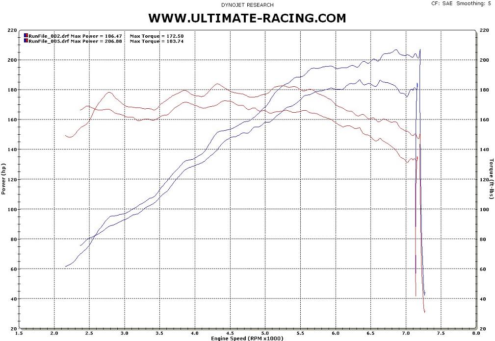

The lack of torque made 8th users want to do the k24 bottom end if they didn't want to go turbo/supercharger. See the huge spike when vtec engages. Yes, they had a vtec intake and exhaust cam. The 9th doesn't have that, but it does have more consistent torque down lower in the rpm range. The 8th gen required you to rev it out much higher to get that torque.

The vtec crossover on the 8th gen isn't all sound. Notice the big bump in hp & tq where the vtec crossover occurs. The K20Z3 head flows great for higher peak hp. The K24 block has a similar bore size as the K20Z3 (87 vs 86 mm respectively) but it has a higher stroke, 99 vs 86mm. This is where the increase in torque comes from. When you combine the torque of the K24 with the high-rpm attributes of the K20, you get the best of both worlds known as the frankenstein swap as mentioned by webby.
