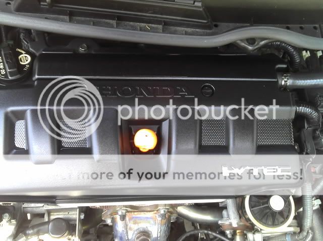

Tak - The <3 of my 9th Gen Civic FB2
I was thinking about putting an ivtec badge and call it done. But it looks ghetto and cheap.
If I do so, is the heat in engine bay gonna melt the 3m tape?
Not in that area. Go drive for a while and then pop the hood. You should be able to put your hand on the cover without pain. Most engines tend to run at under 200 degrees. And thats the temp in the block, yes with coolant running through, but even so, the entire under hood temp should be well below 200. IIRC, we feel "pain" from touching something at around 140 degrees. That should give you some idea of how hot the plastic cover gets.
Real 3M brand tape should be able to hold up to those temps with no problem. That cover might get to 100-120 I would bet. If you can get your hands on a digital laser temp gauge it might be worth driving around vigorously and then popping the hood and temping the cover just for fun to see.
It will hold just fine, my friend put an vtec badge he bought on ebay for his r18 and it has held up just fine.
