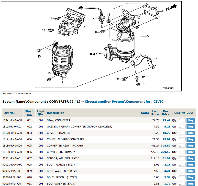

Webby, I wasn't aware that there are two catalytic converters. I thought there was only one at the top of the exhaust pipe right after the exhaust gas exits the engine. Where's the second one :confuzzled:
Underneath the head where the silver heat shield is if that makes any sense
Turbo'd since 04/2011
1st cat off the head... #6
----- 2nd one below on the exhaust ... #1
