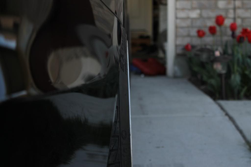

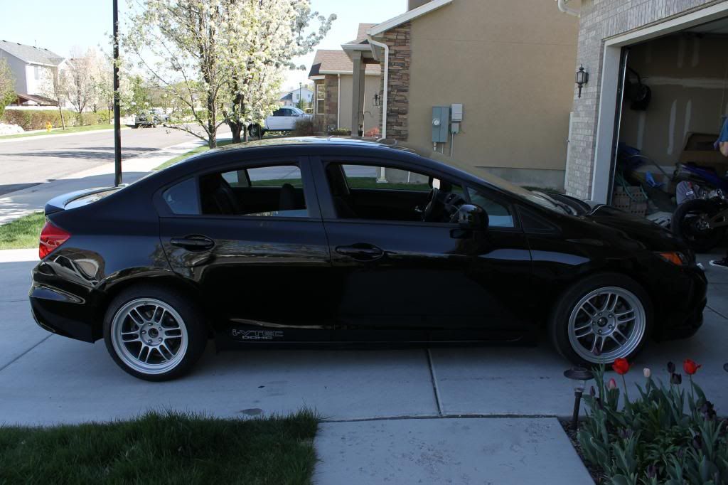

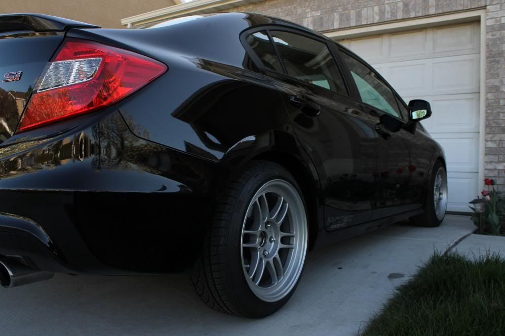

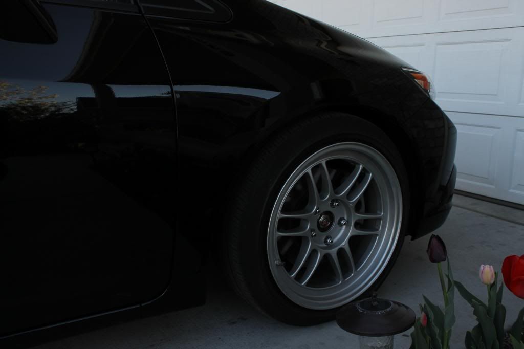

Got my rpf1 17x9 +35 on 215 45 17 and theres no poke at all the way i like lol
