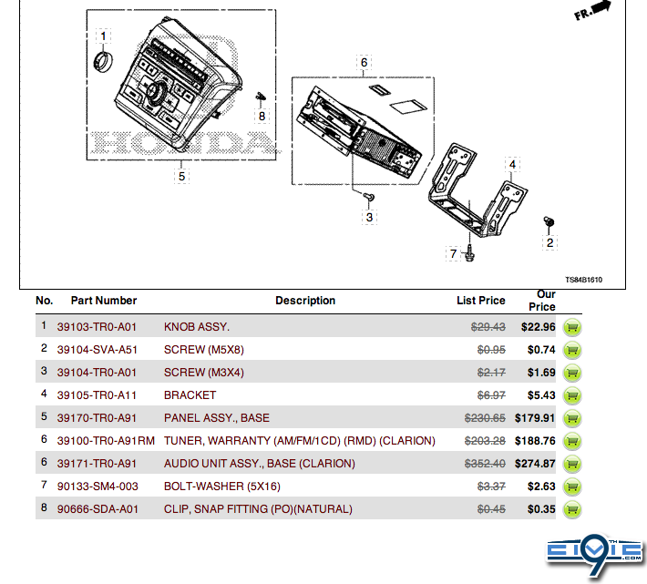

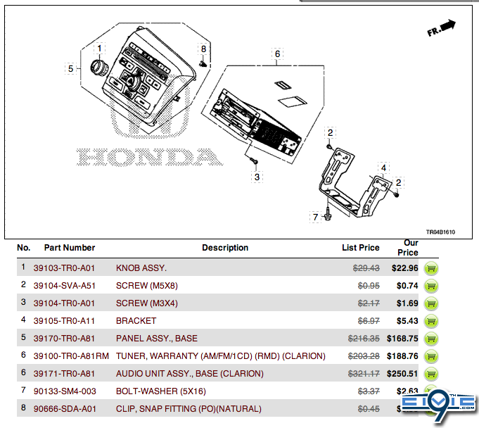

I have civic Sedan EX, someone know if the factory radio comes with conection to install amplifier and sub?
52,105
22,314
from looking up the part #'s to the sedan EX -
2dr EX-L part numbers do not match up below -
the SI sedan part #'s match up with these ^ (coupe ex-l). So, I would say the units are not the same/do not have the same plugs. If they did, I can't see why the coupe part #'s match the sedan Si #'s.
9thgizzyguy
1,183
455
Civic si RR
He is correct factory radios do not come wit pre outs
