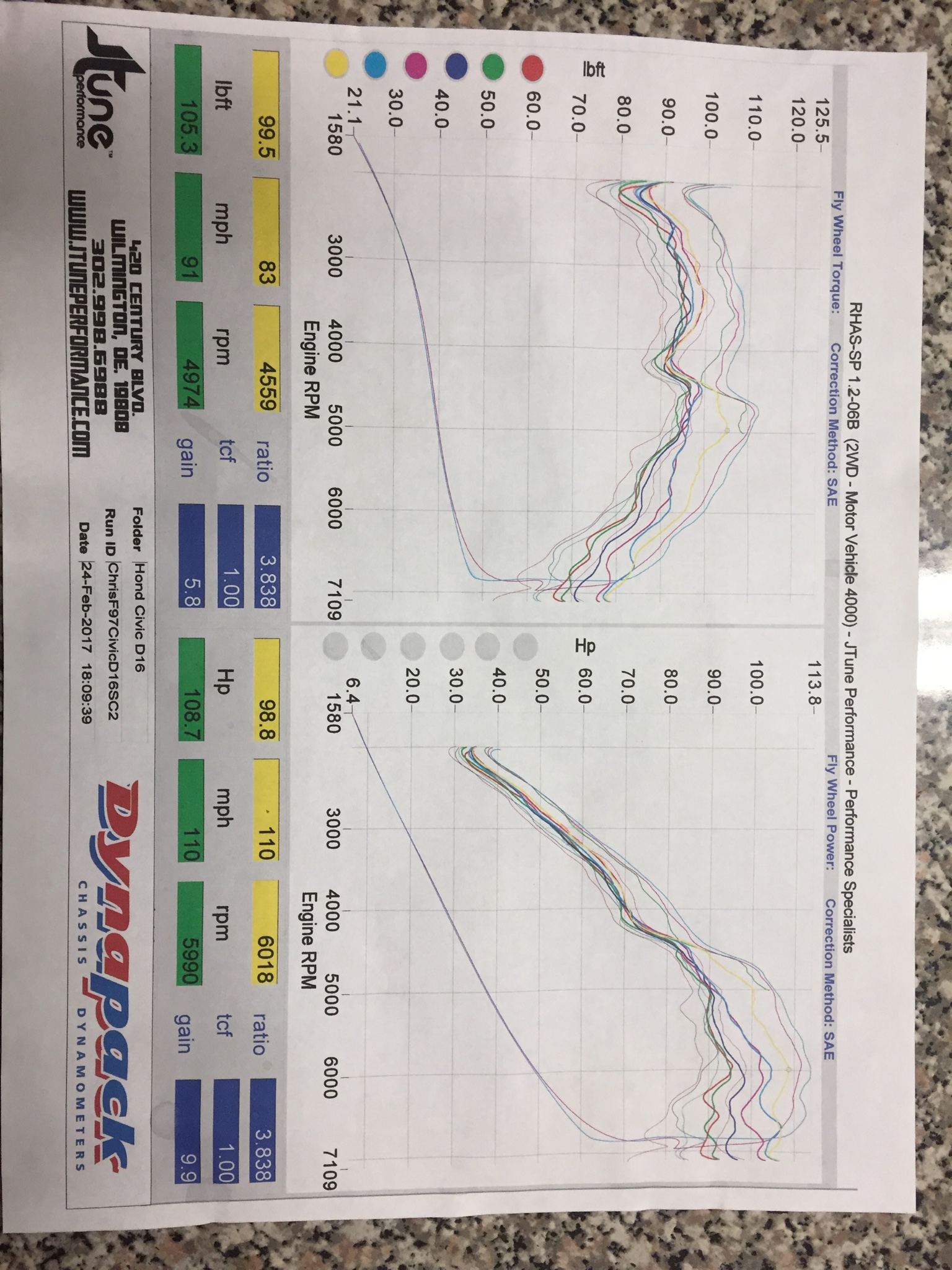

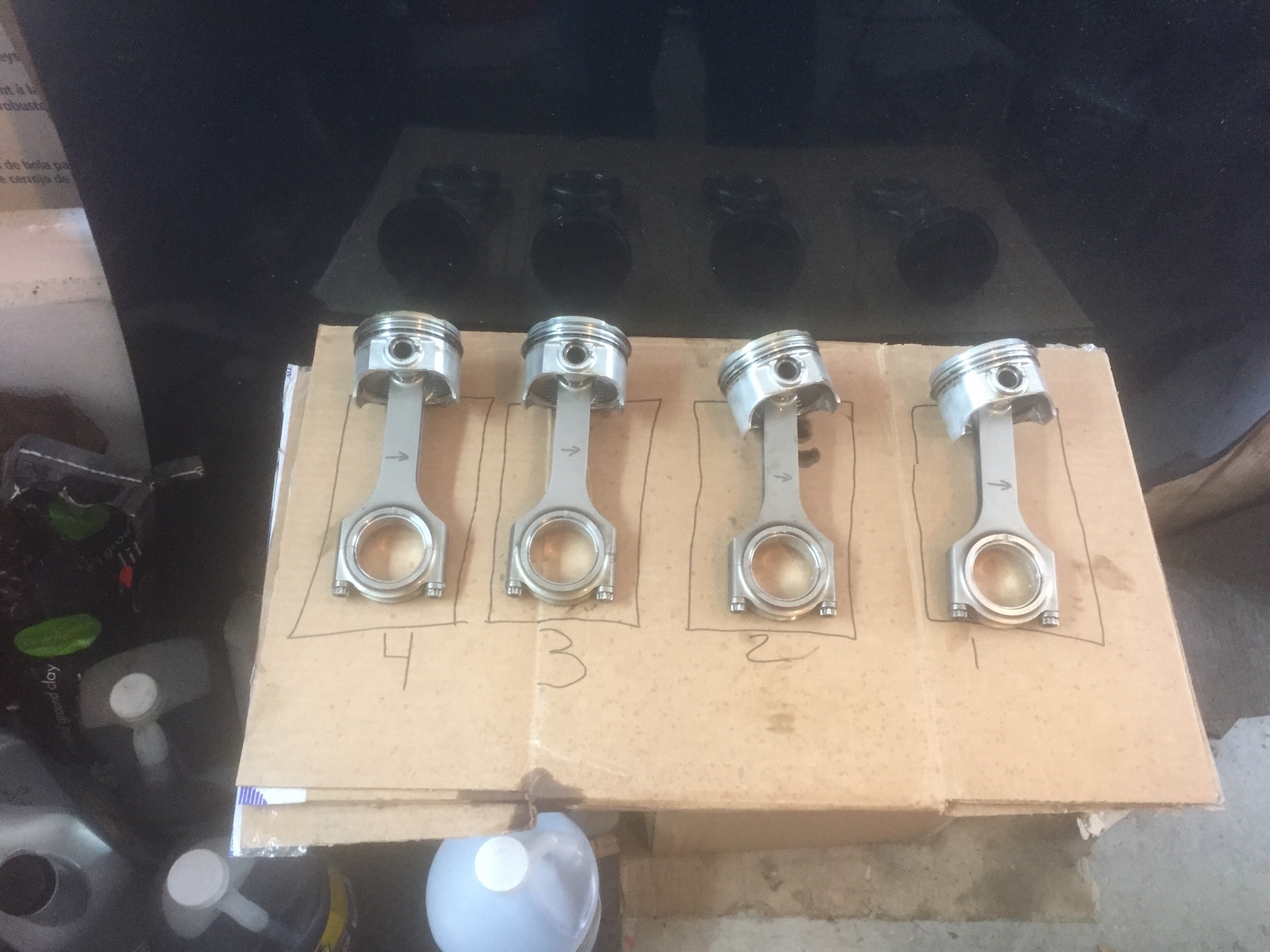

Disappointingly low power output. Come to find out that my compression ratio is way too low. Looking at a different set of pistons. If you look at the graph though the curves are at least pretty solid and the torque curve is pretty flat. Wound up making 10psi of boost on the dyno.

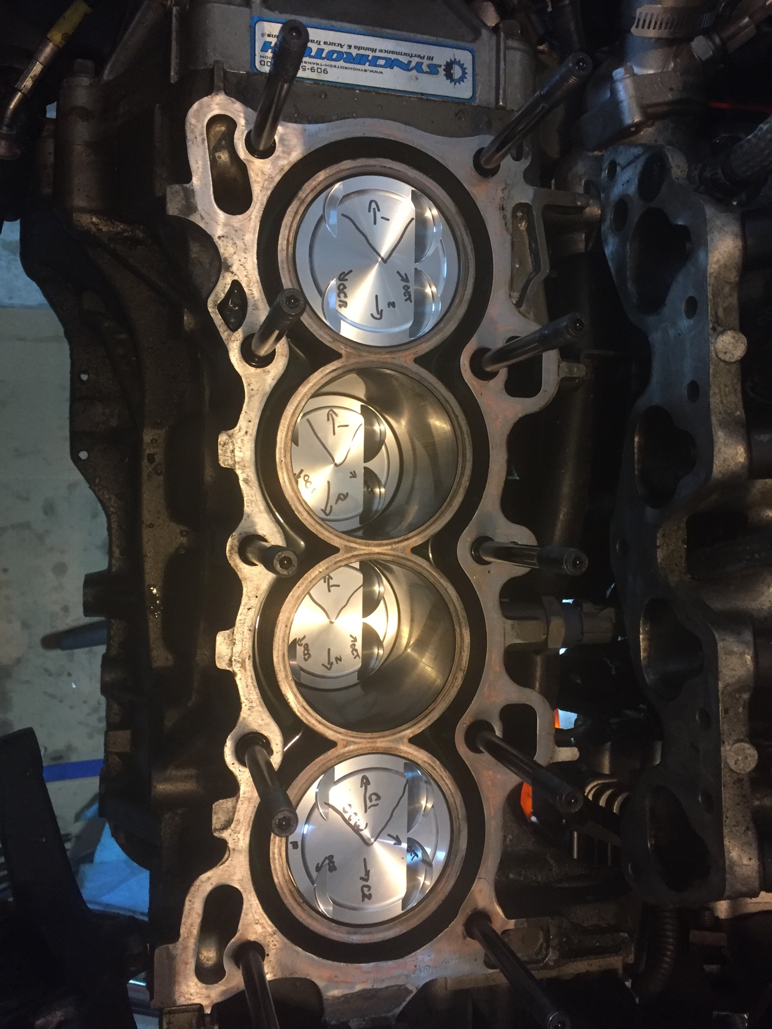

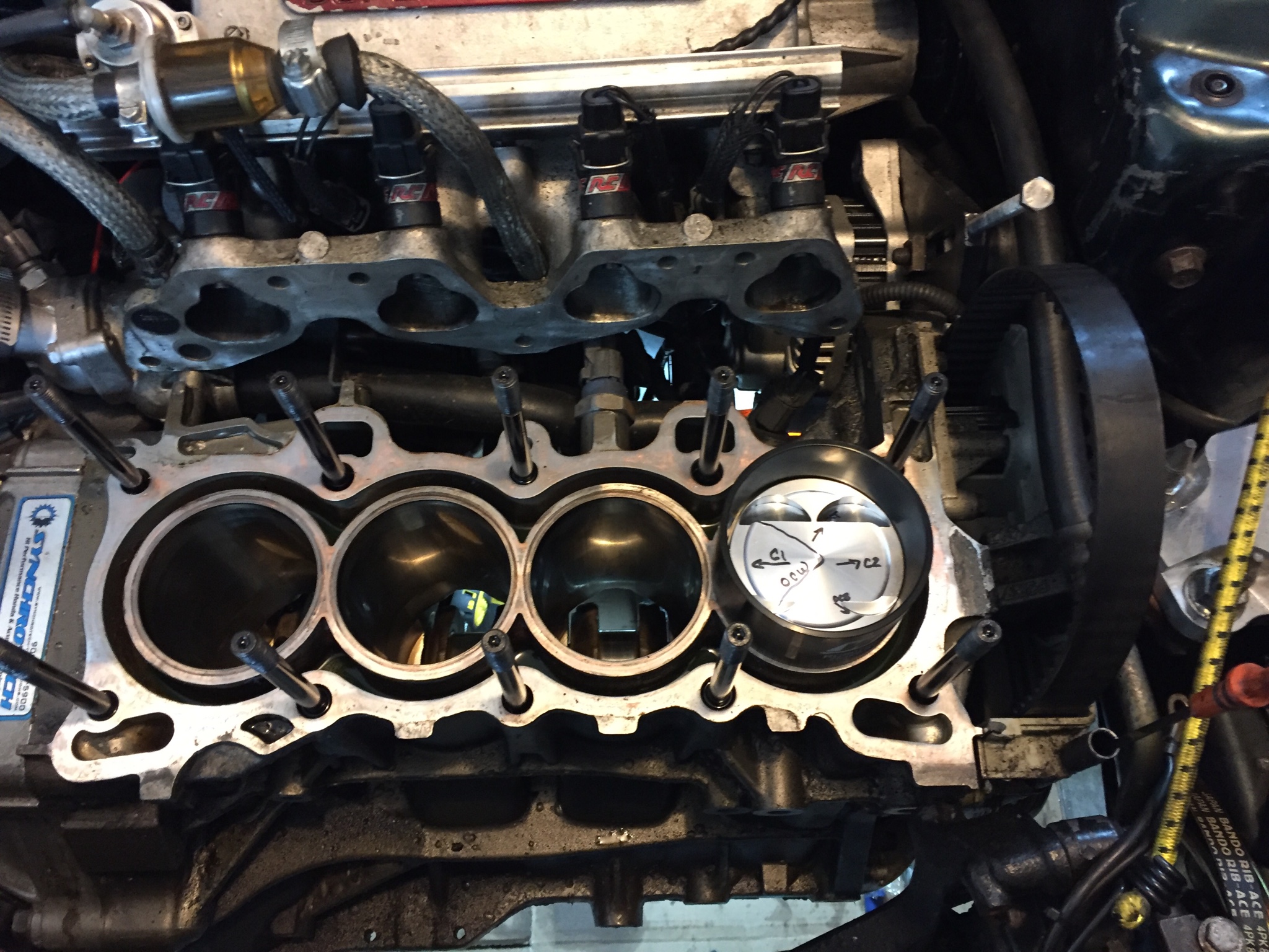

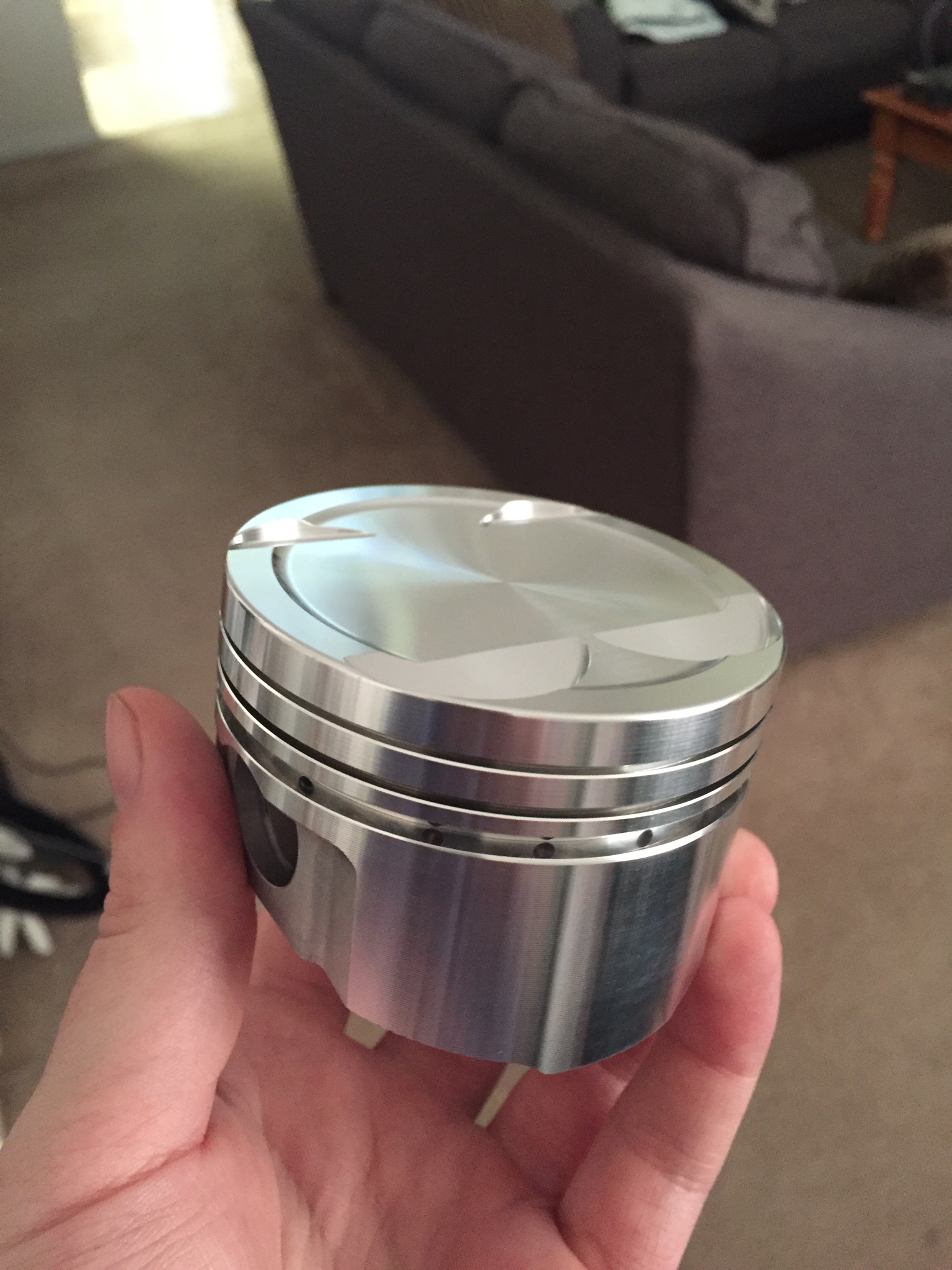

So having been completley dissatisfied with the results I got i did some financial wizardry I have a box full of needed parts and fluids waiting to build this engine again. Just waiting for the pistons to be milled and mailed to me then i can get started. My backs gonna be killing me cause im doing all of this with the engine still in the car.

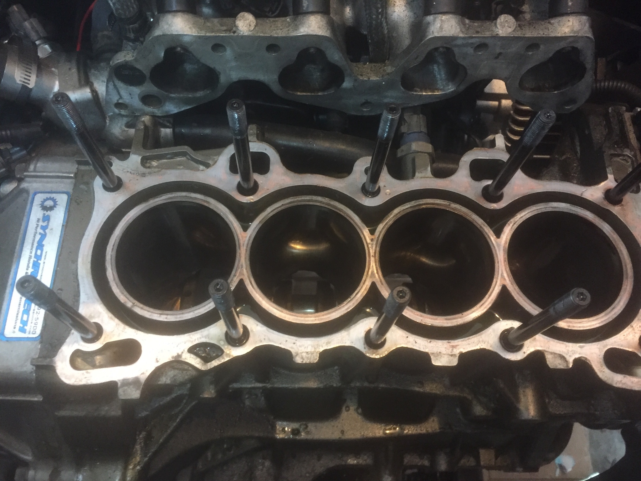

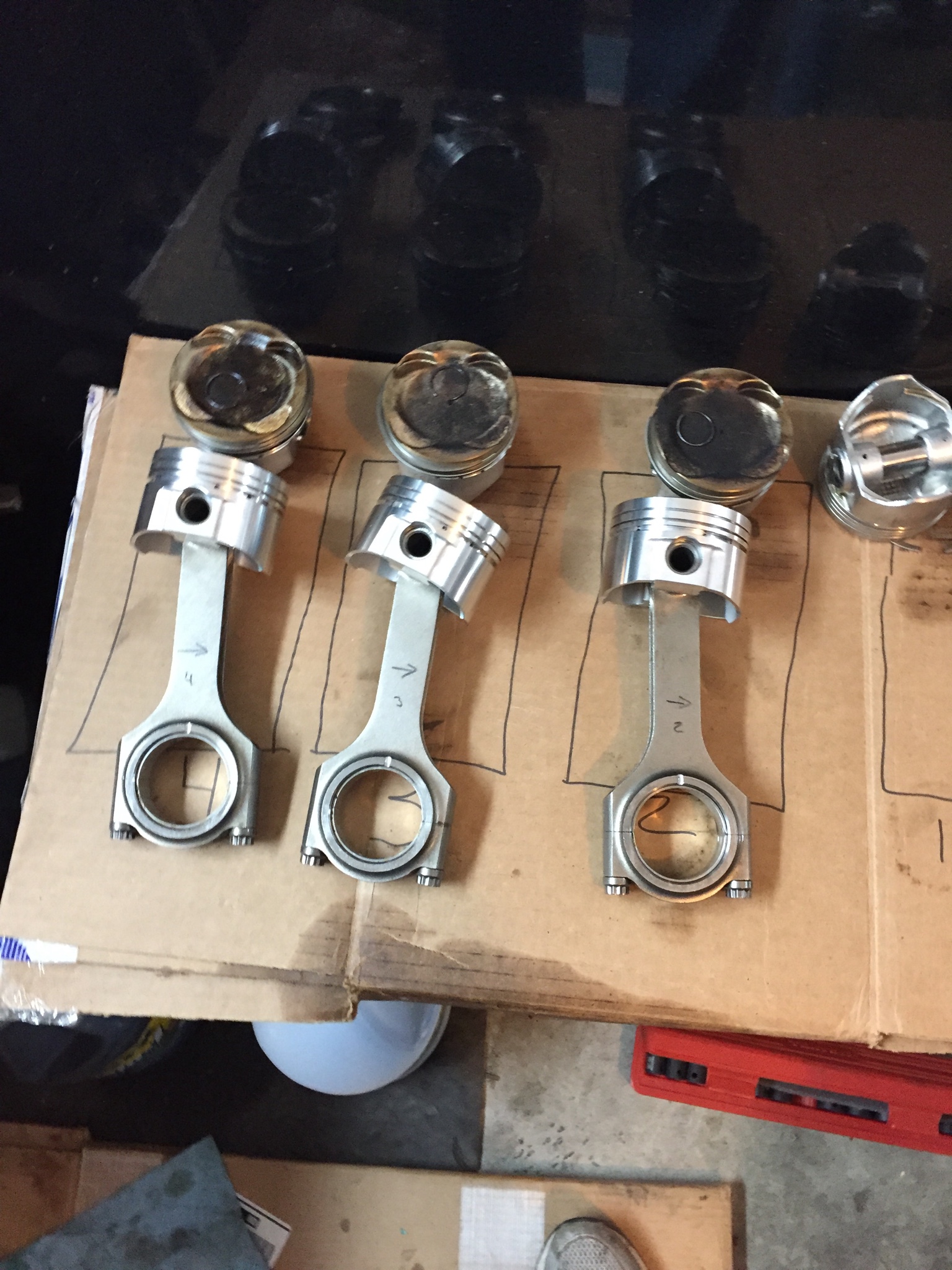

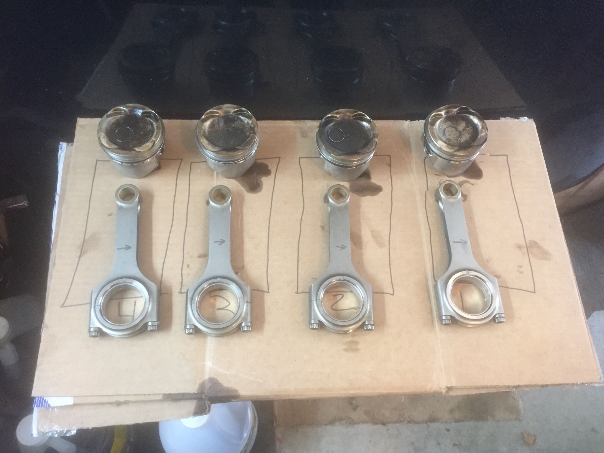

Tear down is now complete.

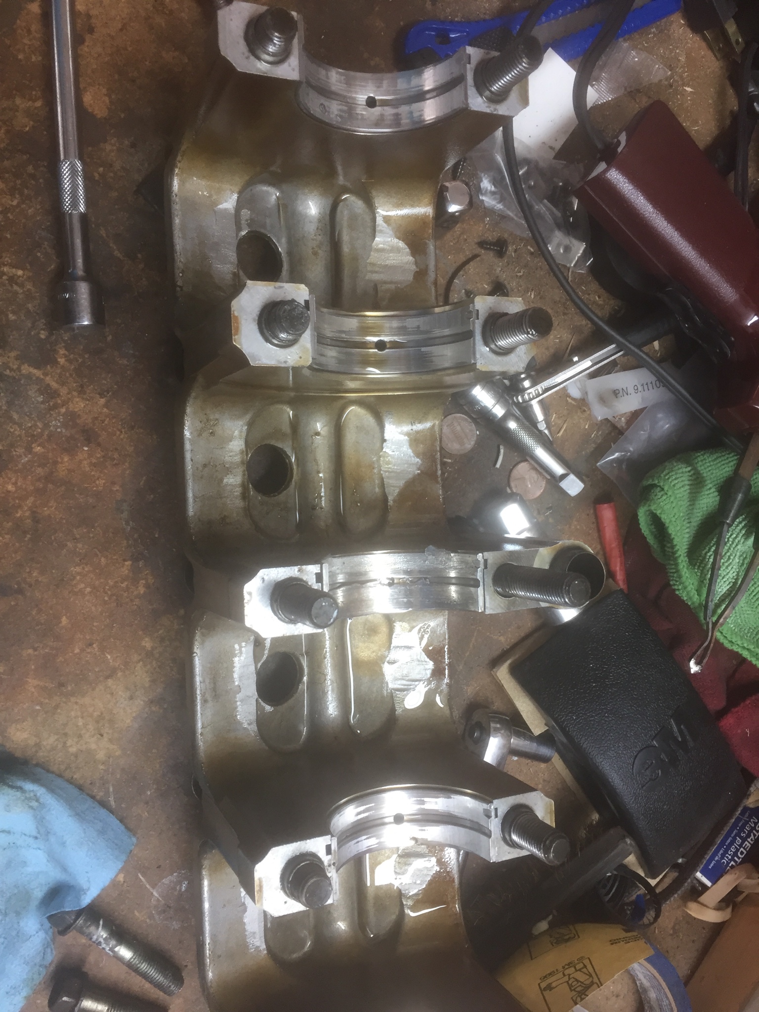

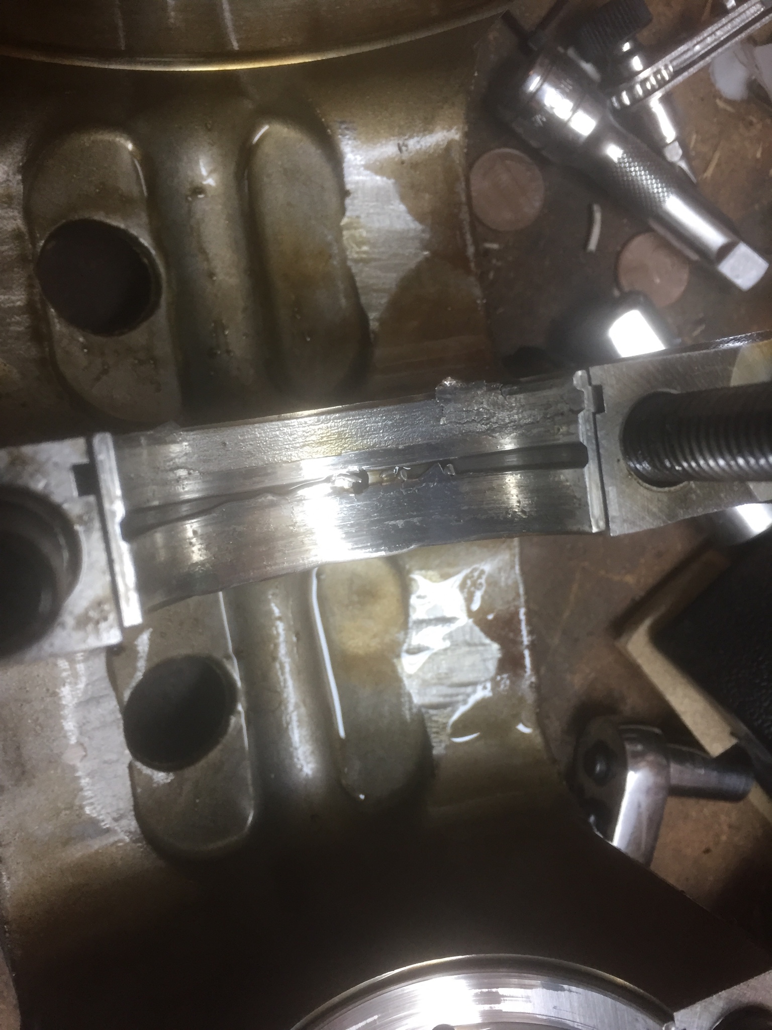

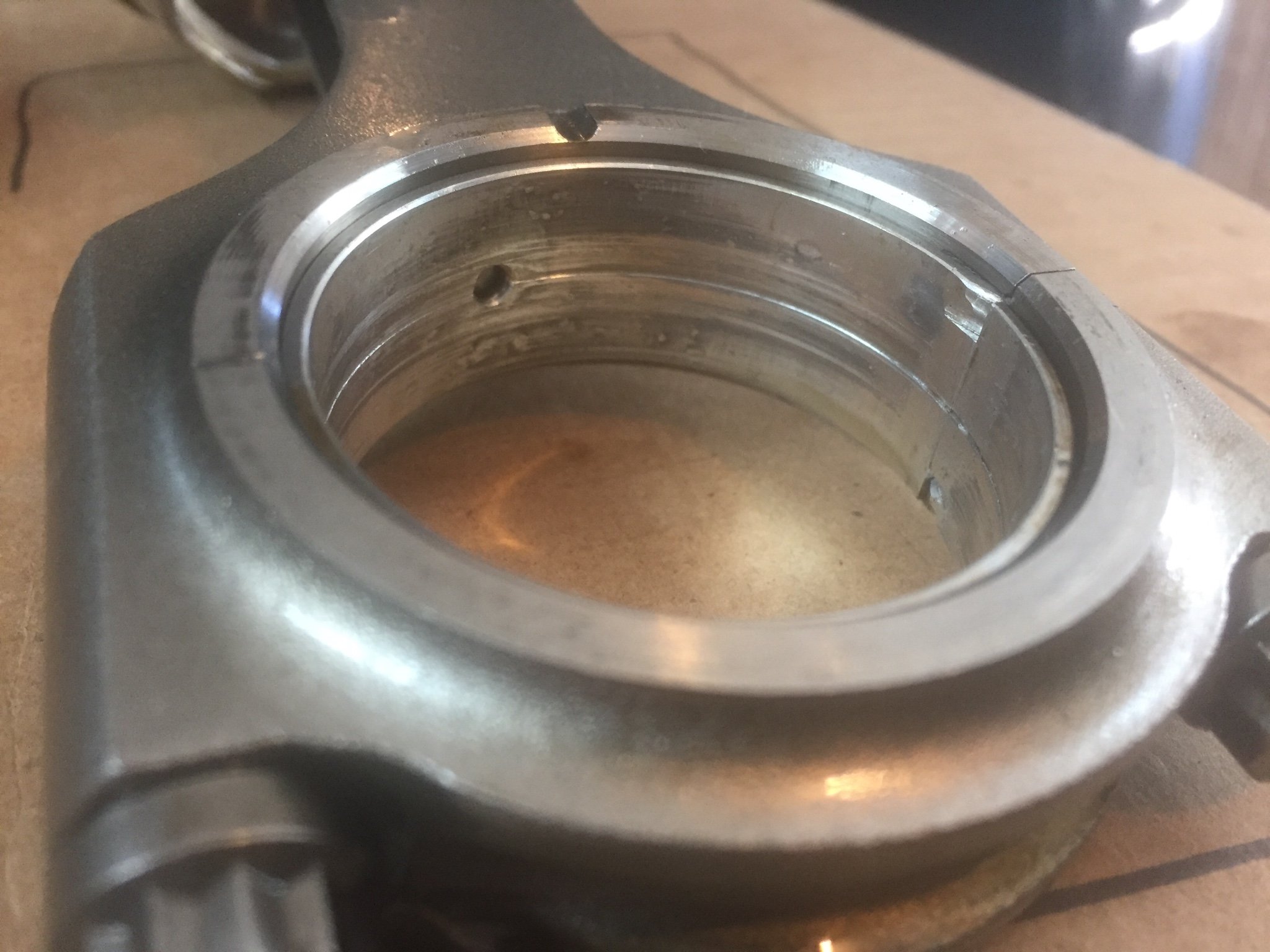

Unfortunately I found some signs of wear I didn't like.
Gonna have to flush all the oil passages, get another new set of bearings (main and rod) and then bust out the plastigauge again. Wasn't prepared for the extra work but honestly at this point with this car I'm not even surprised.

Ouch. How's the crank looking at least?
Not a scratch thankfully. This is the second time i've eaten a set of bearings. I'm going to flush all the oil passages in the crank and then plastigauge every lobe when in install the new bearings to make sure everything is still in spec. I have a feeling that because i ran the car for so long on a really rich tune i may have lost some lubrication to fuel soak which caused this issue. Crazy part is there were no signs of it, oil pressure was spot on, and no unusual noises.
