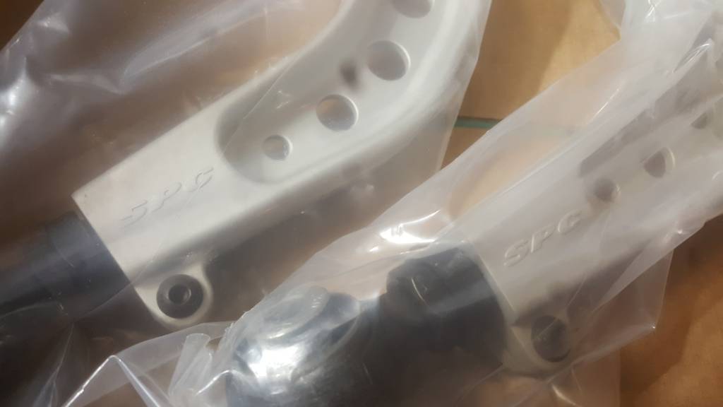

dorman camber arms - spc brand in a dorman box.
http://9thcivic.com/forum/threads/littleshaks-orange-blossom-special-build.13617/page-2#post-361603
info and link ^. They sell them as single pieces, so you need to order 2 of them to fit the rear.

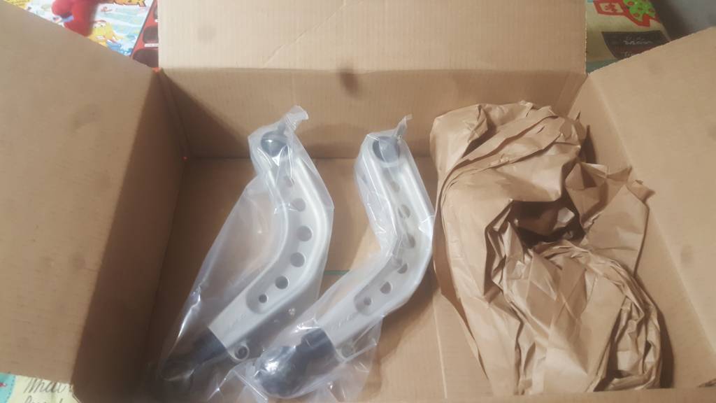

How long does it take to put these rear camber arms in? Mine just got in today, looking to install tomorrow
dpetro1
477
342
Catonsville, MD
Should only take an hour per side.
My suggestion is to put a jack under the rear spring to keep it compressed while you remove the control arm.
Set the adjusters to max distance per the instructions then let the alignment shop tweak as needed. Just make sure they don't extend beyond the stated range.
Sent from my SM-G920V using Tapatalk
bauer311
3,083
2,093
Fayetteville, NC
Thanks, that's how I have them set, but if don't have a big enough wrench to adjust the camber any more. I'll let them know about the specs when I take it in for the alignment. You were right on the money though, about an hour per side.
