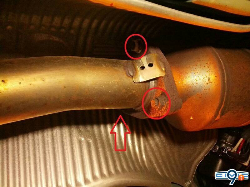

    For everyone that used jackstands, how did u get these bolts off??Lol! Breaker bar?

    Just doubled up on some wrenches after letting pb blaster soak in for a few mins

    Patience, PB Blaster, breaker bar, impact wrench. Make sure to use a 6 point socket and not a 12 point.

    Well i sprayed the **** out of it with pb spray but still wouldnt budge so i just pulled the entire exhaust out.

    Its just scary to crack those nuts because it moves the whole exhaust. I actually tied a rope around my exhaust and around a tree to take some pressure off the rubber when I was pulling mine...
