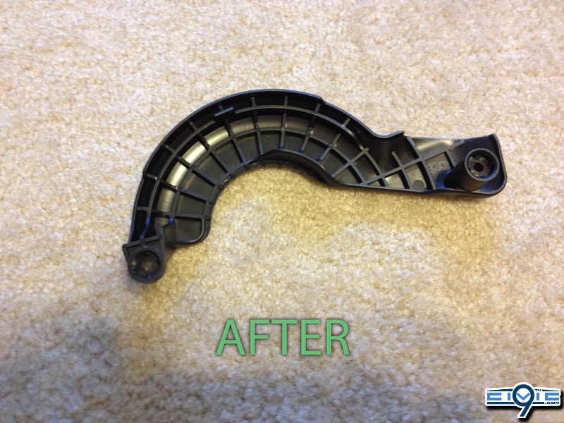

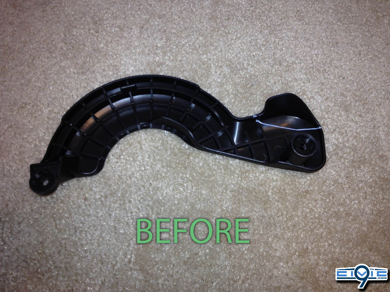

i am so scared to cut the blower cover that is the only hold up on me doing the
install
You only need to remove a small portion of the blower cover. The template in the kit is helpful to get an idea of what to remove. The cover is made of rigid plastic and cuts pretty easily with a hack saw. It would be very hard to make a major error doing this. I say go for it. The lights are a nice factory touch you can add with very little effort.
The light is definitely dimmer than the driver's side if you don't cut the blower cover but it hasn't been a big enough difference to convince me to cut mine yet.
I cut mine it only took like 30 sec with a little hack saw and all the light shines through now.

so i didnt cut my blower motor cover anyone got a pic of it cut so i can tell a diff
There are photos of the cover in the first post. Is that what you meant, or...?
