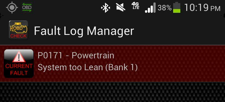

Help?
Got this CEL on my way home tonight, just driving normally.
The first thing I thought of is I haven't cleaned my intake filter in almost a year, could it be as simple as that?
Or any other ideas?
A lot of times, cleaning the MAF sensor and finding/fixing vacuum leaks fix the problem. If you're on a tight budget, start there, but that may not be the fix for certain. So, possible solutions include:
-Clean the MAF sensor. Consult your service manual for it's location if you need help. I find it's best to take it off and spray it with electronics cleaner or brake cleaner. Make sure you are careful not to damage the MAF sensor, and make sure it's dry before reinstalling
-Inspect all vacuum and PCV hoses, replace/repair as required
-Inspect all hoses and connections in the air intake system
-Inspect and/or test the intake manifold gaskets for leakage
-Check for a dirty fuel filter and proper fuel pressure Ideally you'll want to monitor short and long term fuel trims using an advanced scan tool
-If you have access, you may want to run a smoke test
Read more at: http://www.obd-codes.com/p0171
