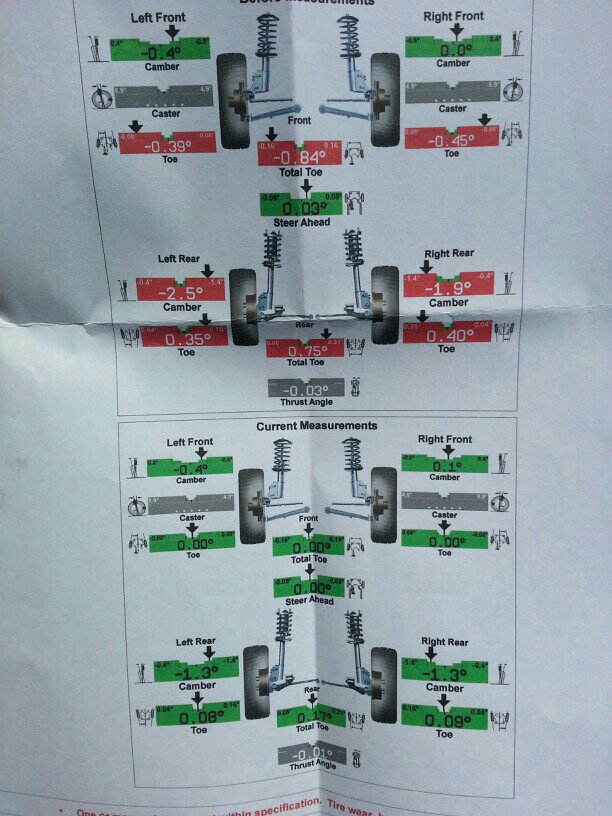

General recommendation is you'll need a camber kit after an inch of drop to even out the rear camber and avoid unnecessary tire wear
trustdestruction - would you mind posting your alignment sheet? Just so we can compare the difference from a slight 1" drop to the large 2+" drop joeliu posted.
I copied his over on the last page. His alignment was way out but again, a much more significant drop. It might help people decide when they are going to need camber adjustability or how much a drop they want to go with.
I'm doing my sportlines Monday and will be doing my own alignment at work. Being a tech with unlimited resources ftw ..
I'll post up what I come up with. Then a week later I'll align it again once everything settles.
I didnt get a printout, their printer was broken. I asked the tech and he said it was nowhere close to being out of spec.

Just installed my sportlines. Using godspeed camber arms, I measured then out and made them identical length as stock arms. Then onto the alignment rack I went. Had about 2.5 and 2.0 in the back for camber. Toe also way out. I'd say with the sportline drop, if you want your camber around stock numbers you need the arms. Here's what I was faced with and adjusted it to.
The right one wouldn't be locking the bushing side into the center by the looks of it. Neither are really right though. You want even amount of threads on either side of the center nut. Then you loosen the lock nuts from their locked positions, which would be the left picture, and you turn the center nut, it then either pushes the bushing side further out or in since one side is left hand threads and the other is right hand threads.
None is correct. Keep them fully closed or fully screwed in. Then you adjust according to the camber setting. If you do either one shown in the pic, you won't be able to adjust the camber arms correctly.
Do it this way:
Fully closed.
Adjusted to the correct setting/length using the middle bolt:
Left bolt and right bolt are locking nuts and should look like this.

OK, I think i got the idea. So picture 3 is the final result everything locked in place? The distance between the left nut/bolt and the right nut/bushing has to be about equal?
Yeah, last picture is it locked down. Go by those pictures, start with it basically all touching and then turn only the center nut which will move the two pieces away from each other equally, then lock the nuts down like in the last picture.
