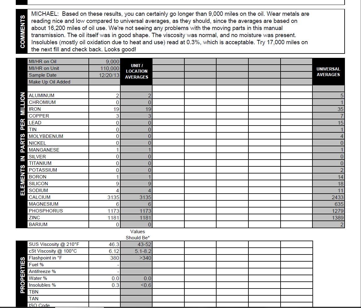

Keeping on topic, I am very anxious to see how the OEM fluid performs. My bet is that it will get a glowing mark of approval from Blackstone.

I'll post and repost my 3 MTF reports for comparison. The first two were ugLY (Amsoil MTF ) and the last one -- 12k with OEM -- was mostly normal. Despite the Amsoil providing horrific results, Blackstone agreed with Amsoil corporate that it was probably just break-in.... so Blackstone didn't do me any favors there, despite the results being off the charts bad.
What worries me most is that the tranny hasn't been the same since... between 2nd and 3rd it almost shifts itself. Didn't yours (with a steady diet of Amsoil) need rebuilding at like 80,000 miles?

Still, i'll use whatever fluid holds up best according to fluid analysis. For me, with 3 fluid changes done between Honda and Amsoil, the Honda MTF is the clear winner. But i'll be trying others... so we'll see.

Just awesome... best report i've ever seen. Did you do anything special during the rebuild?

I suppose it's simply the Honda MTF. It's not synthetic, no.
Switched to the type R final drive. Replaced all bearings. Nothing else special.
