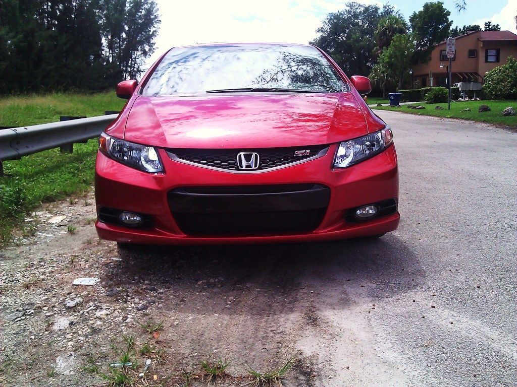

Hey guys just finished up this project and decided on posting the materials you need to make your DRL's white if you want to.

I hope this helps some of you, i personally love the look and can't stand the yellow bulbs.
I'm no expert but through trial and error got here, feel free to ask any questions.
This picture is in broad daylight at noon, will take another in a bit
