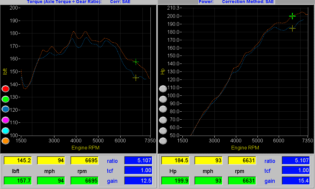

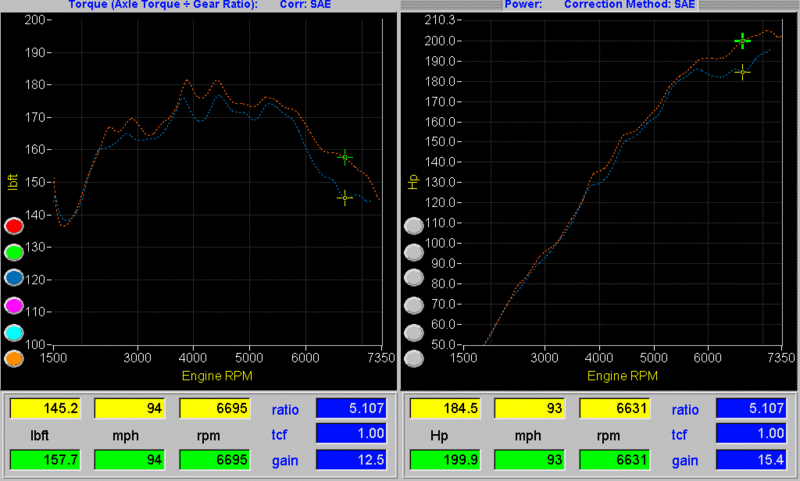

Did you guys notice on Hondata's web site they changed the dyno graph from when it was first released?
Looks like 199.9hp / 157.7lbft..
^^Thats a far cry from what they were originally advertising!
I see that! *Shakes fist*
I'm mad that I put that 220hp sticker on my back window. ;-)
looks like they're using the same dyno, but they've marked the points at where the largest hp/tq GAINS are.... not peak hp/tq #'s...
look at the graph... the points are not the peaks.

looks to be a few issues.
1 - hondata used a car with ~50 miles on the odometer, then did the next dyno at ~2500 miles. Most would agree that your engine is not 100% at 50 miles on the odometer.
from their site -
hondata said:
The stock dyno pulls were done on the Civic when it had less than 50 miles and was not fully run in. The ECU tuning was done at a later time when the engine was making more power. We retested the reflash against the stock ECU at 2500 miles and have adjusted the power figures to more accurately reflect the power gains.
They're still saying :
  • 10-15 top end HP gain depending on the dyno and modifications
  • 5-12 ft lb top end torque
The graph still shows areas that have the largest gains on the chart. They aren't advertising the peak hp/tq figures on the dyno. Look where the crosshairs are on the 2 different dyno graphs.
1st dyno published -
2nd dyno published
