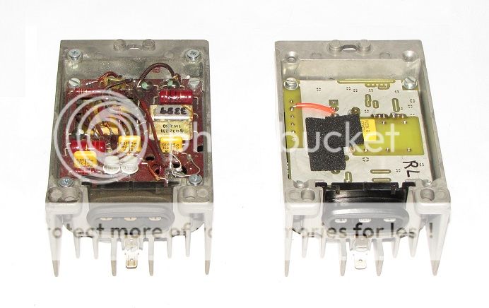

Mechanic is still claiming nothing is wrong with the CDI box, next time im in the shop im going to grab a wrench and just take the box out of the car, send it off to a company i found that will replace the internals with modern digital ones and set a rev limiter in the ignition box instead of the centrifugal one in the distributor

Fuel pump relay, new fuel distributor since the twice rebuilt one still isnt holding even or correct pressures, new fuel pump (go figure those noises ive been saying arent normal for years are suddenly bad), and my personal favorite the CDI+ tuneable ignition system.
Mechanic didnt like the CDI+ when i described it to him, but once i made him put it in the car and get it set, go figure it was the smoothest the car has run to date. The box has all kinds of drivability improving features like double sparking at idle and low rpm (it will actually willingly drive 25mph now), the ability to set electronic ignition advance instead of relying on centrifugal advance in the distributor and in general a much more consistent and stronger spark than stock but at lower voltage that doesnt tax the coil. Plus the guy who designed and sells it is an engineer and i had a lengthy conversation with him about it.

CDI+ also means if some day say carrera RS camshafts finds their way into the engine, the advance curve can be adjusted to optimize the engine for the new configuration. Its all adjustable from a laptop interface
