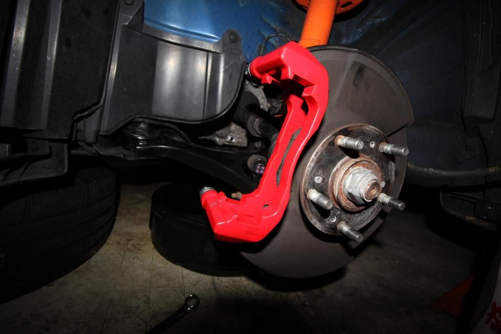

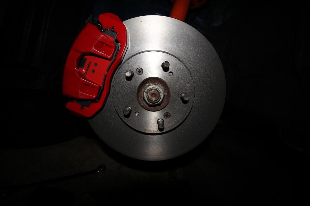

I installed the Russell SS clutch line and added Motul RBF600 fluid. I still need to change the trans fluid, install Russell SS brake lines, and install the TSX brake parts.

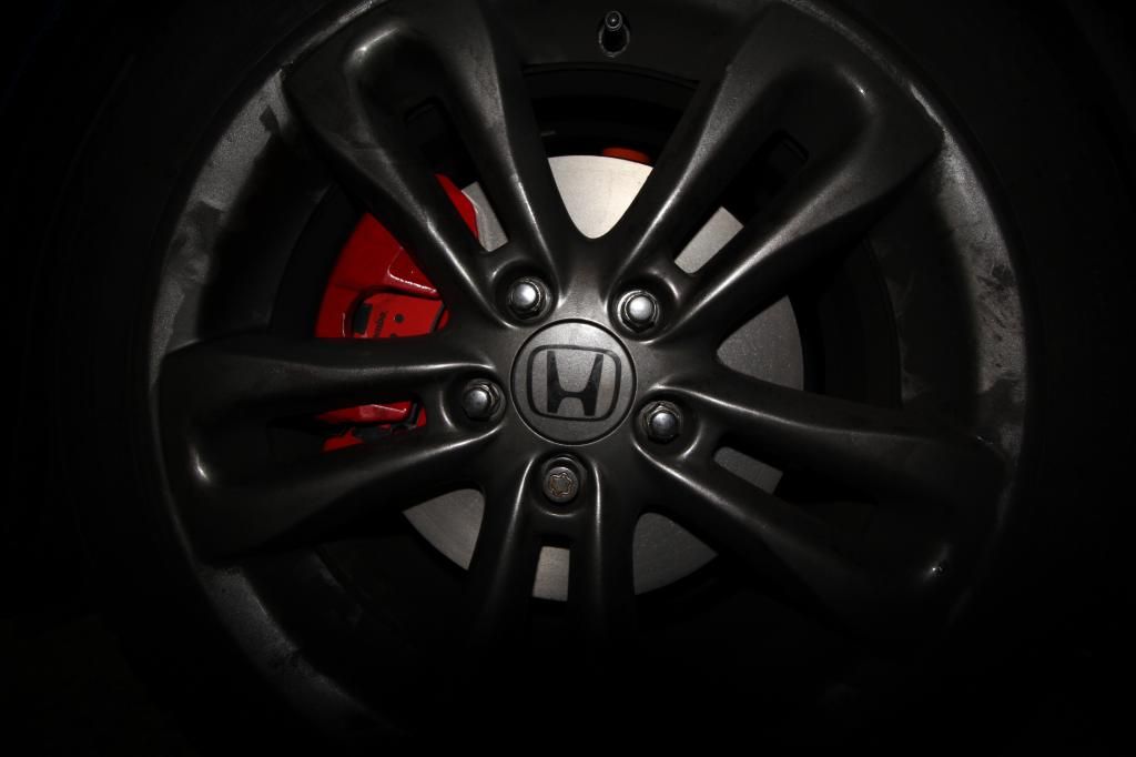

I'm running two sets of wheels(stock for regular and TSX wheels for winter). Both wont clear the tls calipers unless I run spacers which I don't really want to do. I have a long weekend. I'll have them done before Labor Day.Gotta change that mtf man don't wait to long. Why TSX and not the tl type s?
I'm running two sets of wheels(stock for regular and TSX wheels for winter). Both wont clear the tls calipers unless I run spacers which I don't really want to do. I have a long weekend. I'll have them done before Labor Day.![]()
Also the TL-S Brembos require drilling the mounting holes on the knuckle. Permanent modification. I know they will hold up fine but I don't like the idea of reducing the metal of a mounting point in a high stress & load area.

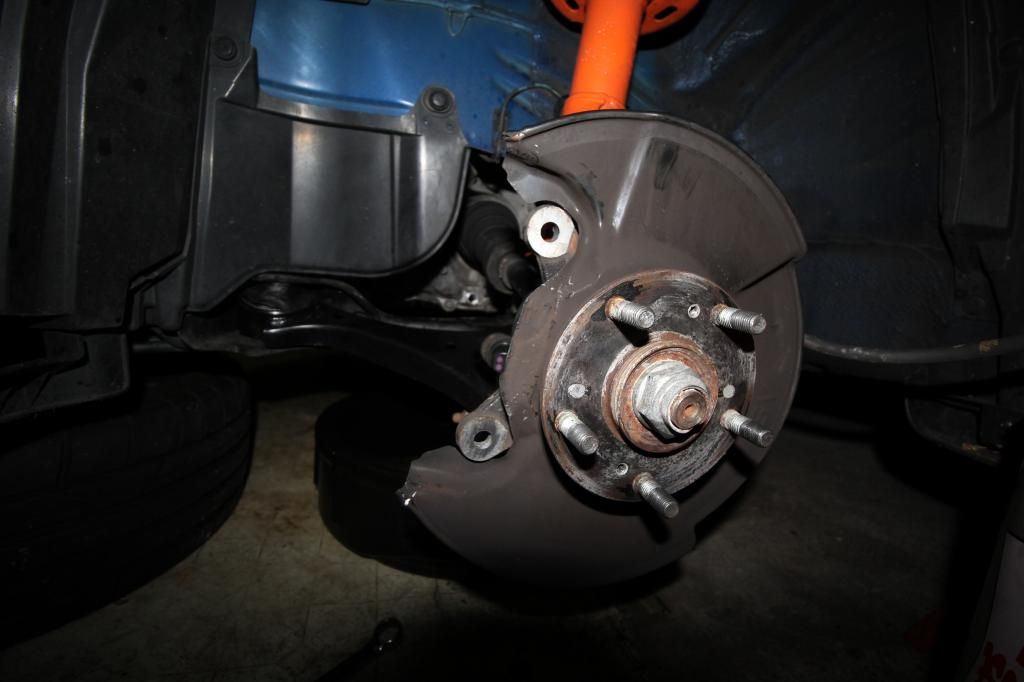

I figured that since it is a thin piece of metal, it will be very easy to bend. So I used a vice grip to shape it so that it will clear the caliper bracket.Bended it? hahaha I had heard one person say they didn't trim the shield somehow. Does it just rotate out of the way?
