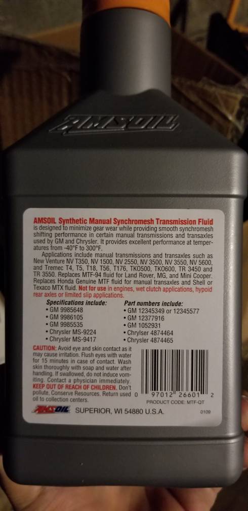

I have never used octane boosters or race fuel, and while on that oil I specifically made sure not to use any additives so I would get a solid base for testing in the future.
Here it is, right on the bottle. I find the bit that specifically mentions Honda MTF to be interesting - it works but it doesn't, lol.
