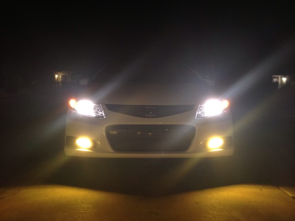

Here's a pic of my yellow 3k bulbs installed.

The LED not that bright here some pics that I got.
when DRL was on
Here when I turned on the high beam and low beam.
They are not bright as the regular high beam.
