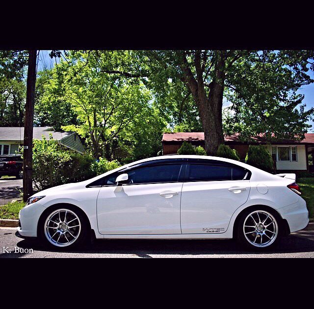

2013 Civic Si with 18x9.5 +23 MB Battles
215/35/18 tires
D2 coils 2" drop front and rear
Rolled fenders

View attachment 52228 Just put on my Gramlights 57 DR 18x8.5 et+38 wrapped on Sumitomo 225 40. I rub only on dips and if I'm turning quickly/hard. Very happy![]()

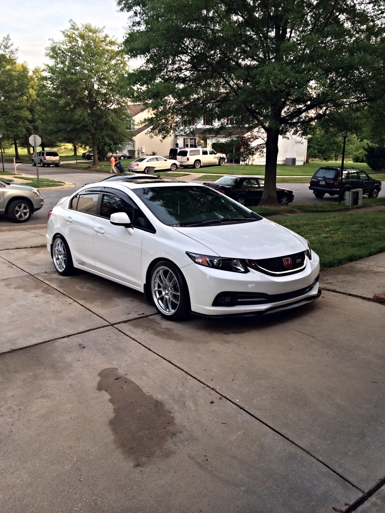

Thanks man, here's a pic of my specs (done today). Honestly, I am highly considering rolling because I do rub on the littlest of dips, it's not annoying, but I'm concerned if the fender and the tire will get damaged. Mind you the rubbing occurs in the front. Otherwise I could just cut the fender liner and see if that makes a difference.Looks great man! Love the color contrast, do you plan on rolling your fenders? Whats the camber specs? Beautiful wheels
Thanks a lot @Nix I really appreciate the advice, and will try to bend those tabs. And if that doesn't help, the bolts sound like a good investment.Get a set of camber bolts and run closer to -1 in the front. It will help with handling and possibly give you enough room to not need to roll the fenders. If you're just rubbing on the very center of the fender, there are metal tabs that the liner clips into. If you just bend those up gently you can tuck the liner behind them. That has also given a few people enough room to not rub. Couple options to try.
