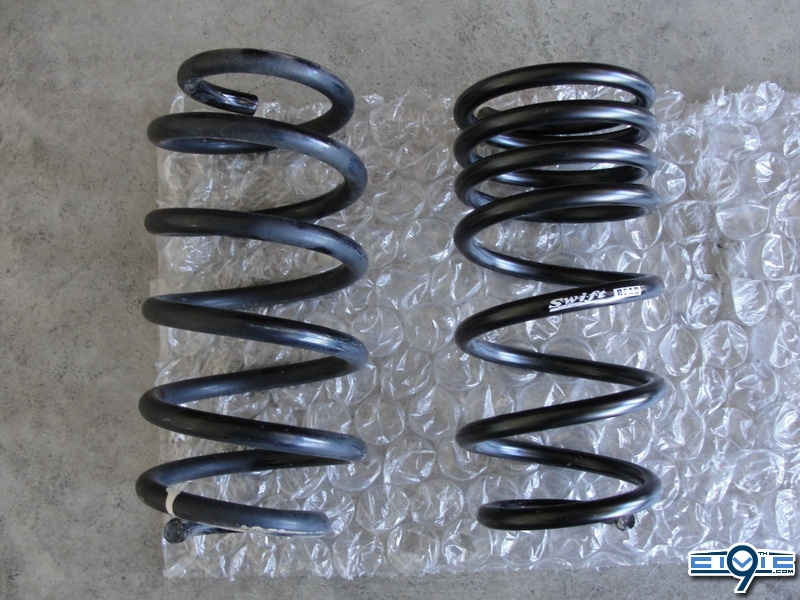

I haven't gotten a response either...Additionally I'm having the same issue that redsfan is having with his springs making noise. It seems like the coils rest on top of each other and make a weird rubbing/bumping sound, Is anyone else experiencing this? Unhappy. :banghead:
No responses to emails via websites. Also PMed the RM rep that was on the forums with no response.
@Eddie...yes, we all are, temp fix is 8th gen upper rubber mounts (modified to remove the middle part). Permanent fix is pending RM.
Only difference is that reds is using swift springs which are leaps ahead of RM's and are also designed for 8th's and he still has issues sounds like waiting for gen specific springs would be the way to go.
I forgot to follow up with the BBB complaint but I will tomorrow. I'm surprised I haven't heard anything but I never expected to receive any kind of refund or reimbursement from RM either way. I did expect to hear something from the BBB by now.
Eddie..the 8th gen insulators will fix the problem.
the coil is pretty tight. As you said the 8th springs, will compress more on the 9th gen car.... I don't know.
Those tight coils are meant/designed to compress all the way though once settled and stay compressed.....at least on the swifts
so what stops others from having the noise on swifts?
I'm prolly gonna look over the front's again this week(end), see if I can identify the noise. Btw, the rears make zero noise.
Might call Chris & see what he thinks too..
