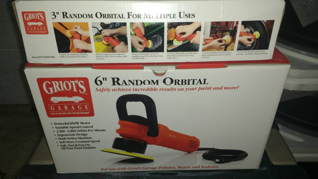

Thanks @Nix! Any recommend on equipment as far as buffer?
hehehe, what's your budget?
There will be a ton of sales coming up with black friday so if you can wait until then you can score some great package deals.
The Griots 6" DA is a good choice for a budget buffer. I have the PC7424 but I felt like it didn't have enough oomph for 5.5" pads and i use it with 3"/4" pads and it works great.
The newer Meguiars MT300 looks really nice and is just slightly more than the Griots or Porter Cable units but without crossing into professional price territory.
If budget isn't a concern the Rupes products are the current "best" buffers out there. Flex make a nice product too. hahah basically you can't go wrong but look into the Meguiars MT300.

Heck yeah man, thanks!
