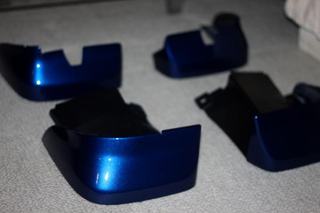

So I bought 1500 grit, 3000 grit, Meguair's M105 Ultra Cut compount, 3" backing plate for the DA, 5/16" to 1/4" adapter for the 3" backing plate, 3" DA Meguiar's Microfiber Cutting Disc to get my newly painted splash guards wet sanded and buffed.
Are there anything else I should get?
I'm planning on using the M105 and an orange pad (to a M205 with white pad, if necessary) for polishing. Then sealant and spray 3M defender afterwards.
Those are pretty small and complex surfaces...I'd probably hand sand them. Are they that rough that they need wet sanding?
I will be hand sanding them. There's some orange peel and a couple of runs that need to be smoothed out. I sprayed 5 coats of clear on them so I wouldn't be worried about going through the clear. And that's the reason why I bought a 3" backing pad. I don't really want to hand buff it bc I'm afraid it won't be effective.
It will be my first time wet sanding and cutting.
