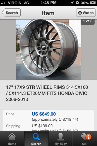

Found another set.hoping this one will fit. Let me know please

That has a +20 offset. The "et20mm" is the offset. The stock wheels are +45.
You can use this tool to see how much of a difference there is from stock to whatever you're looking at. That's going to stick out roughly 1.8" wider from the current stock wheels. You can take a tape measure to see how much room you have to play with.
