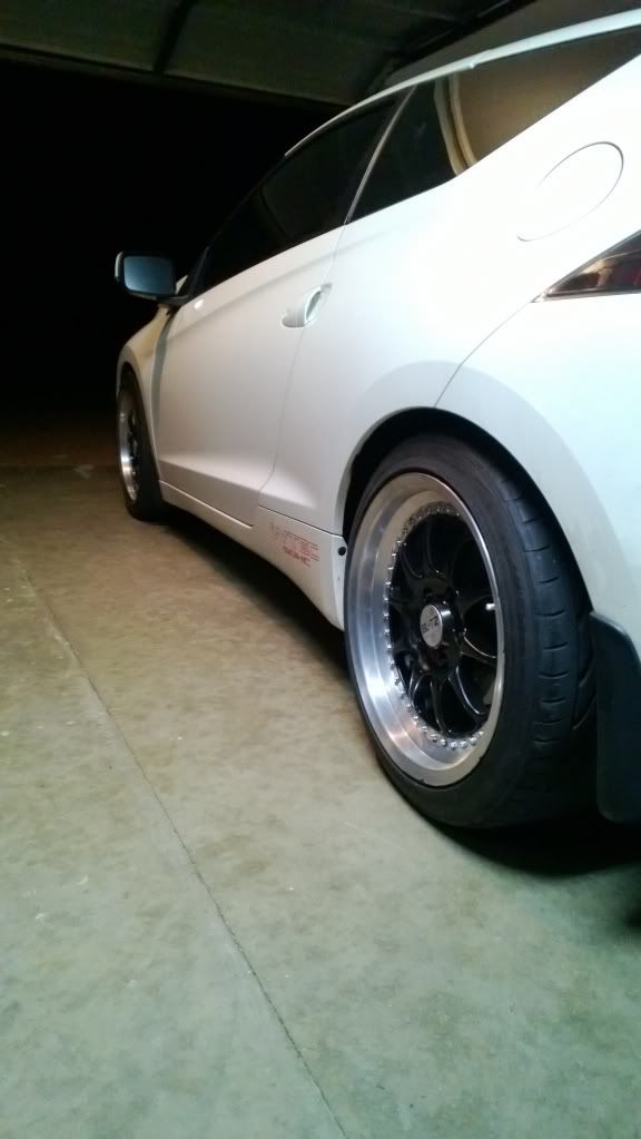

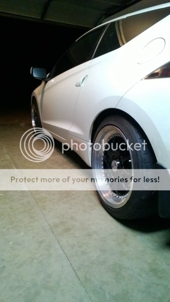

These were my Blitz on my CRZ before the SI. They were 235/40/17. The CRZ was lowered on 1" Eibach Pro Springs and I never rubbed one time. The SI seems to have more play than my CRZ.
Were you lowered or anything?

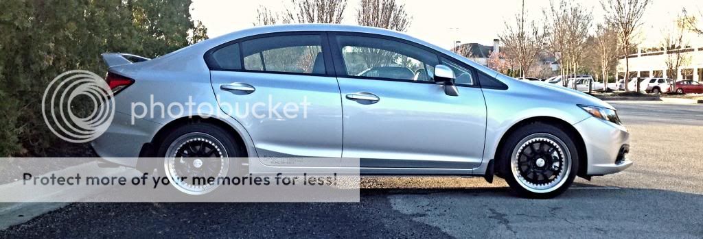

This was when I first got it. I've sent the wheels off for refinishing. These were 235/40/17 in the rear. Seems to have a ton of space and I never had any rubbing while driving.

You rubbing in the front or the back? My front will be 17x8 so it is super flush with the fender and it will be 215/45/17. My back wheels are 17x9 but they are +38 so that is +9 closer to the hub than you are currently. I wonder if that would make enough of a difference to not rub? They sat pretty flush when I tested them.
Yeah 18x9+29 all around, and all four rub if i hit bumps the right way (speed bumps especially)
it would have rubbed way more with 235's lol
