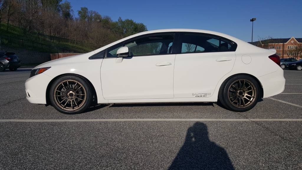

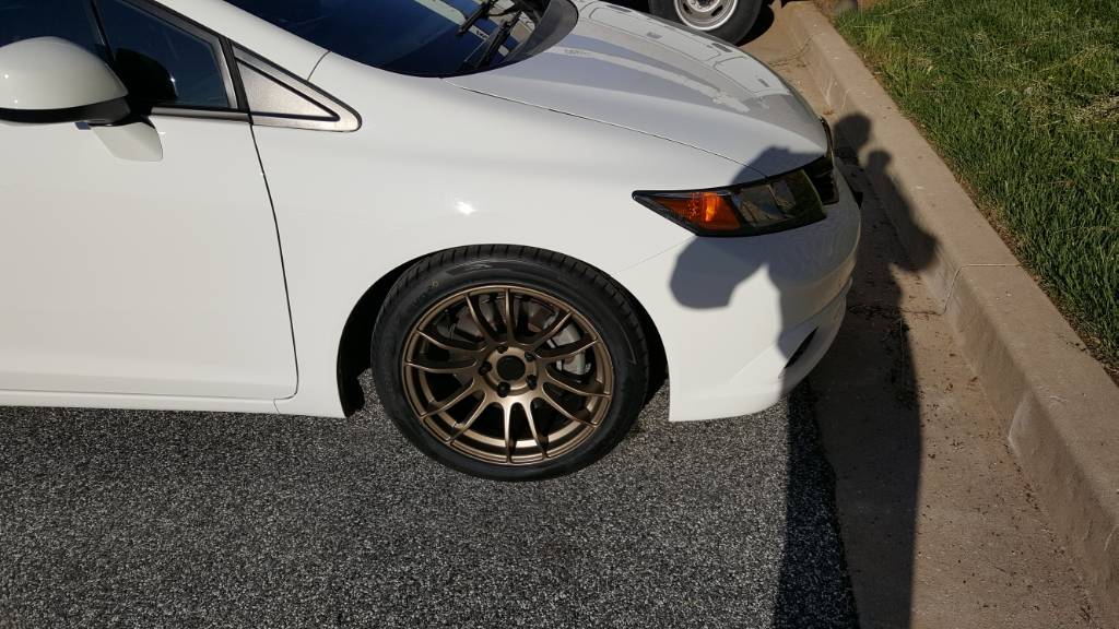

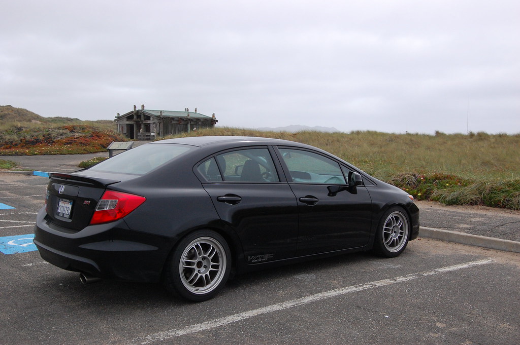

Here's my car with a 17x8 +35 with a 235/40/17:
Only had remove the upper most fender tab of the front fender liner. No drama in the rear.

How much are the cars lowered in those photos? I’m only dropped like 1.2” front, and 1” rear (Swift springs).
52,105
22,314
Thanks very much guys! Y’all really help me zero in on what fits the look I want!
you'd be closer to the white sedan pictured above
