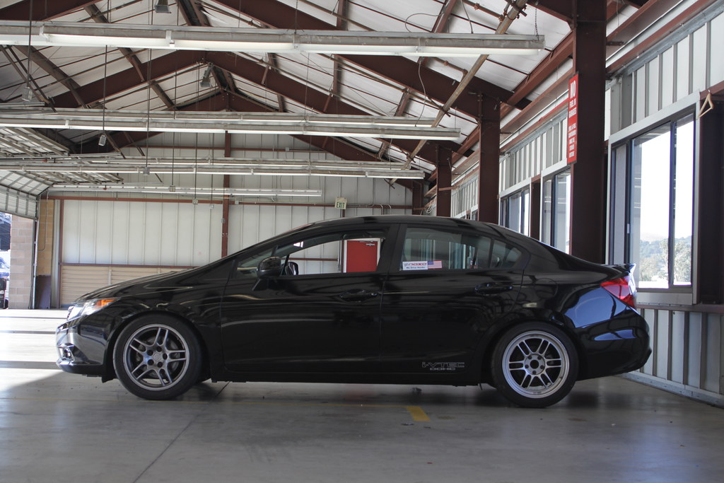

I know this isn't a civic but is this considered meaty? And would that kinda fitment work on a civic? The wheels are ssr gtv02's... if I can get that kinda look I'm going to need these in my life
Doesn't look like it to me. What sizing/spec for the wheels? Depending on what alignment you're going to be running, you can probably run the 17x9 +38et for that wheel with a 235. It's a baby stretch, but if you are open to running staggered, that opens up the door in terms of tire sizing.

I wish I knew I just ripped it offline [emoji85]

Def not meaty... in everyone's opinion what wheel would look best w/ a meaty fitment... *include pics*
