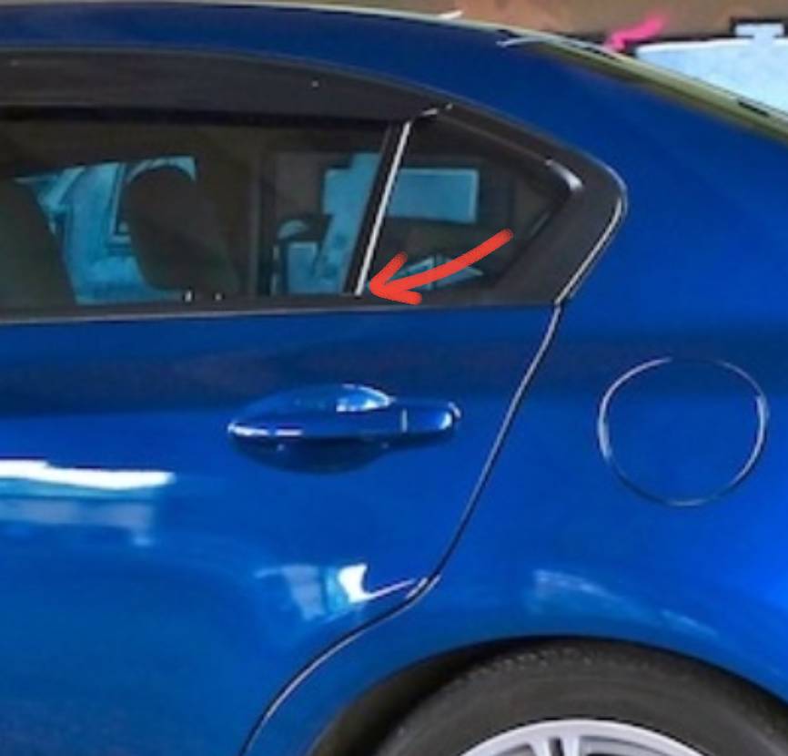

I have some rust started on the bottom of the small black vertical piece the separates the rear window. I'm curious if any other members have had the same issue. I would like to find out how to remove the piece so I can sand it and paint.

rust above like the door handle area where the glass meets the door?
Just swapping bulbs won't give you brighter hids.
Yes. That black vertical piece that seperates the two windows. Anyway to get at the bottom of this to sand it? The rust is at the bottom right beside the rubber weather stripping. Probably goes further down under the stripping too.

Should be identical to this for removing the lower
View: https://m.youtube.com/watch?v=hUaO3OI8-Wg

Thanks Webby! Really appreciate this. You are still your normal helpful self I see.
