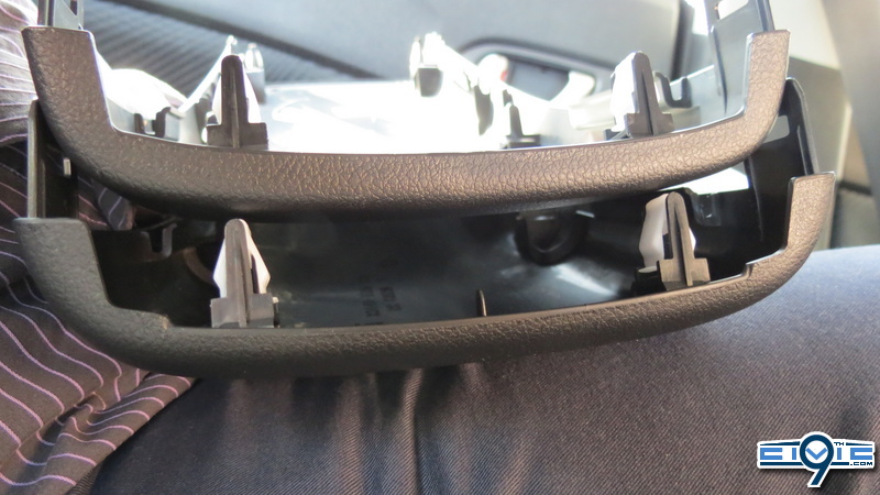

I installed the new 2013 rear console panel with ease and the rub is now completely gone.
The DIY has been updated with the part numbers for it.
Here is a picture showing the design difference. The new rear panel is at the bottom.
The color of the plastic panels for the Si match between both years 2012 and 2013.
Here is a picture showing the design difference. The new rear panel is at the bottom. As you can see,
