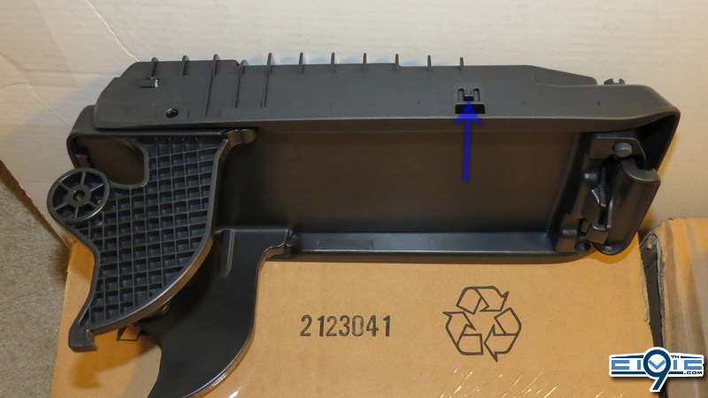

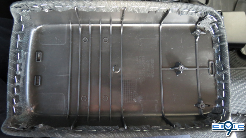

My question is that the top coat appears to have the hinge assembly already on it. I may be missing something so maybe you have a look at these two pictures and let me know what you think.

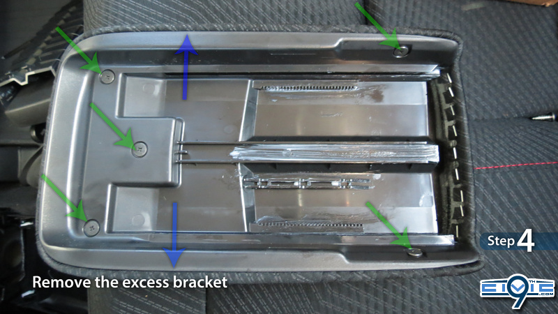

Remove the excess mounting bracket from your new Top Coat Assembly.
To do so, remove all five screws (green arrows), then use your dash removal trim tool to push inward a mounting clip (blue arrows), as indentified in the photos below. The clips are in-between the fabric and the bracket. You only need to push one in, then the entire bracket will come loose.
Note: Honda included two mounting brackets with the Si; one attached to the Top Coat Assembly and one attached to the Hinge Assembly. You only need one bracket.
I do not know if Honda included it by accident or not, so I'm going to assume that this is standard operating procedure.
I have no idea why they gave you a second hinge assembly. The part numbers don't overlap parts. But then again, I have no idea why Honda gave me two mounting brackets.That's what I thought. I just wanted to make sure the hinge assembly on its own wasn't different than the one on the top coat.
