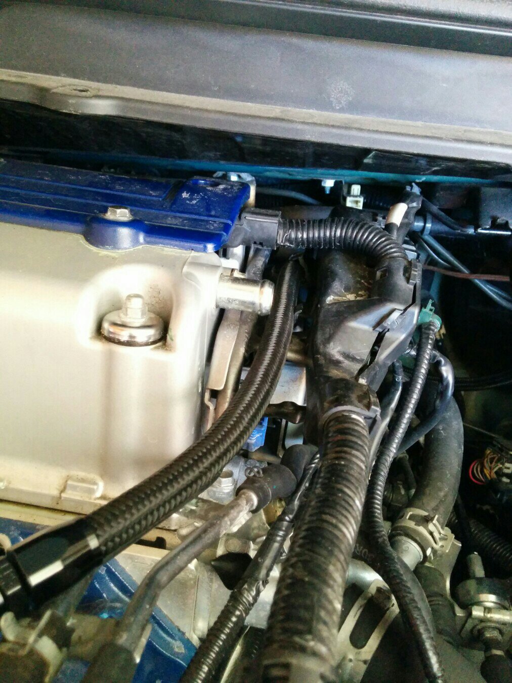

Pics of my progress

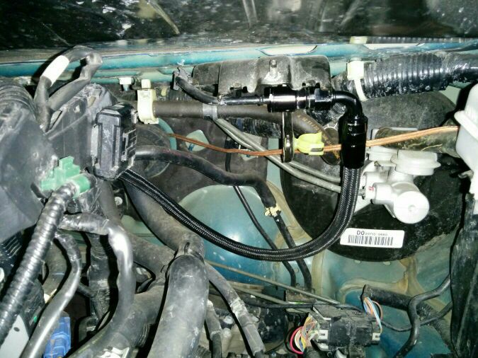

Fuel line

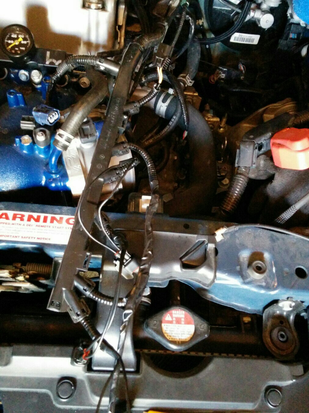

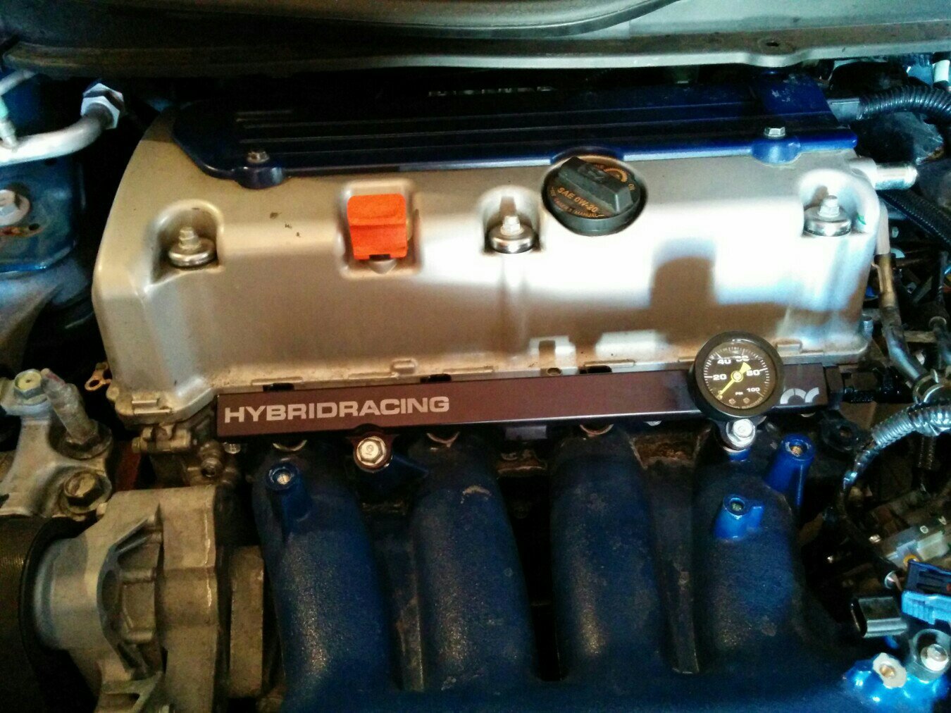

Rail installed

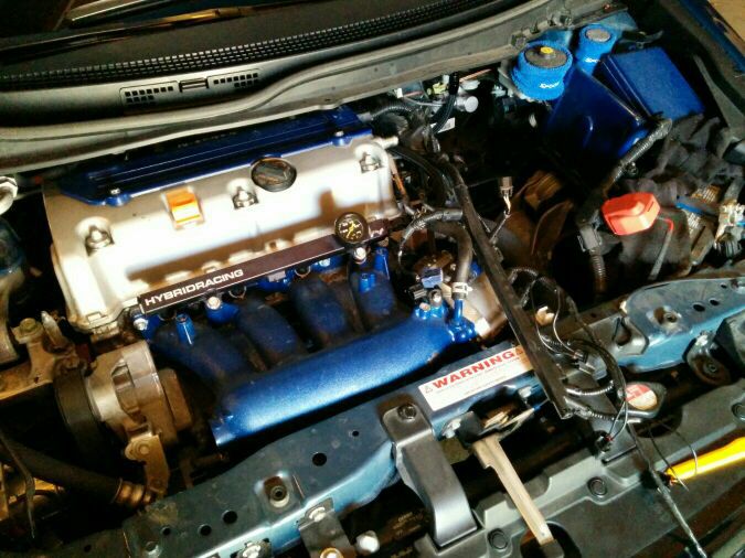

Injector clips spliced in
Is that a quick connect on the fuel line that then accepts a an fitting? Where did you get that?
Car is fine, running good with the new injectors.... Except when I turn on the headlights, then my A/F ratio goes really lean... I'm guessing the ground i'm using for the injectors isn't good... Any other ideas?
You moved the grounds, right? Go back to the bolts in the cover?
Did that today, wasn't the issue though.
I changed the latency values (or "dead times") for the new injectors, but I found out I also had to change a value in flashpro called "current injector test pressure".
So basically, the latency values were right, but the pressure value was wrong. So when I turned on the headlights, the battery was putting out 14v instead of the usual 12v, and although the ecu was compensating for the wrong value at 12v, the ecu couldn't compensate enough for the wrong value at 14v...I hope that makes sense.
