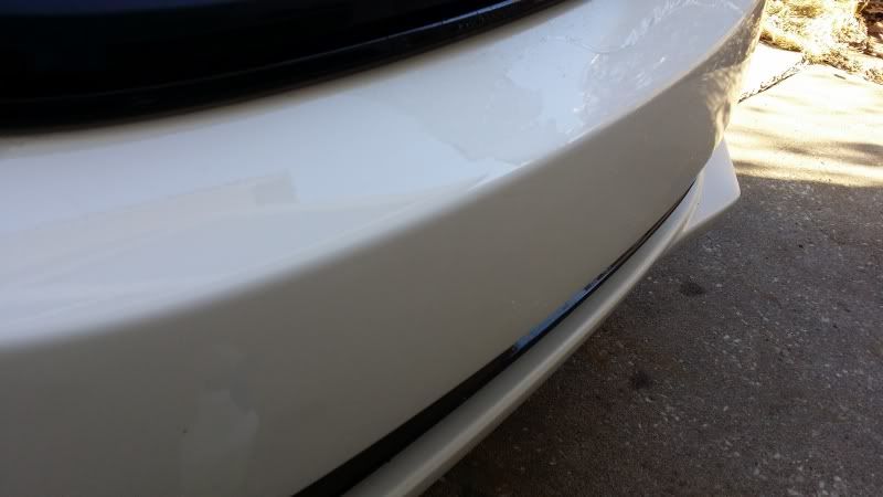

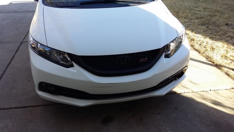

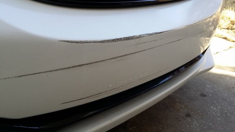

Sorry to resurrect an old post. Wanted to share my experience. My wife backed into my car today and this is the result with the clear bra on
Peeling
Some on the edge. But polished out
Pretty happy with that. The grill got busted but better than re painting a bumper. Just waste time to remove the bumper and peel and reapply.

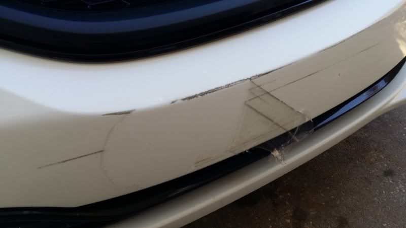

Peeling
