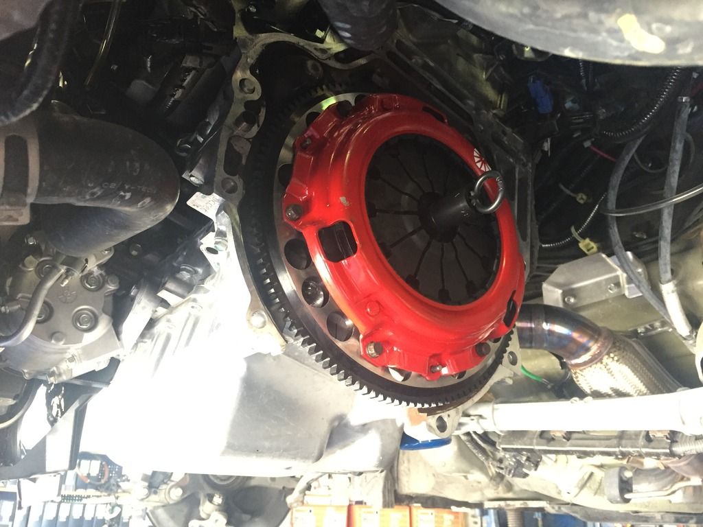

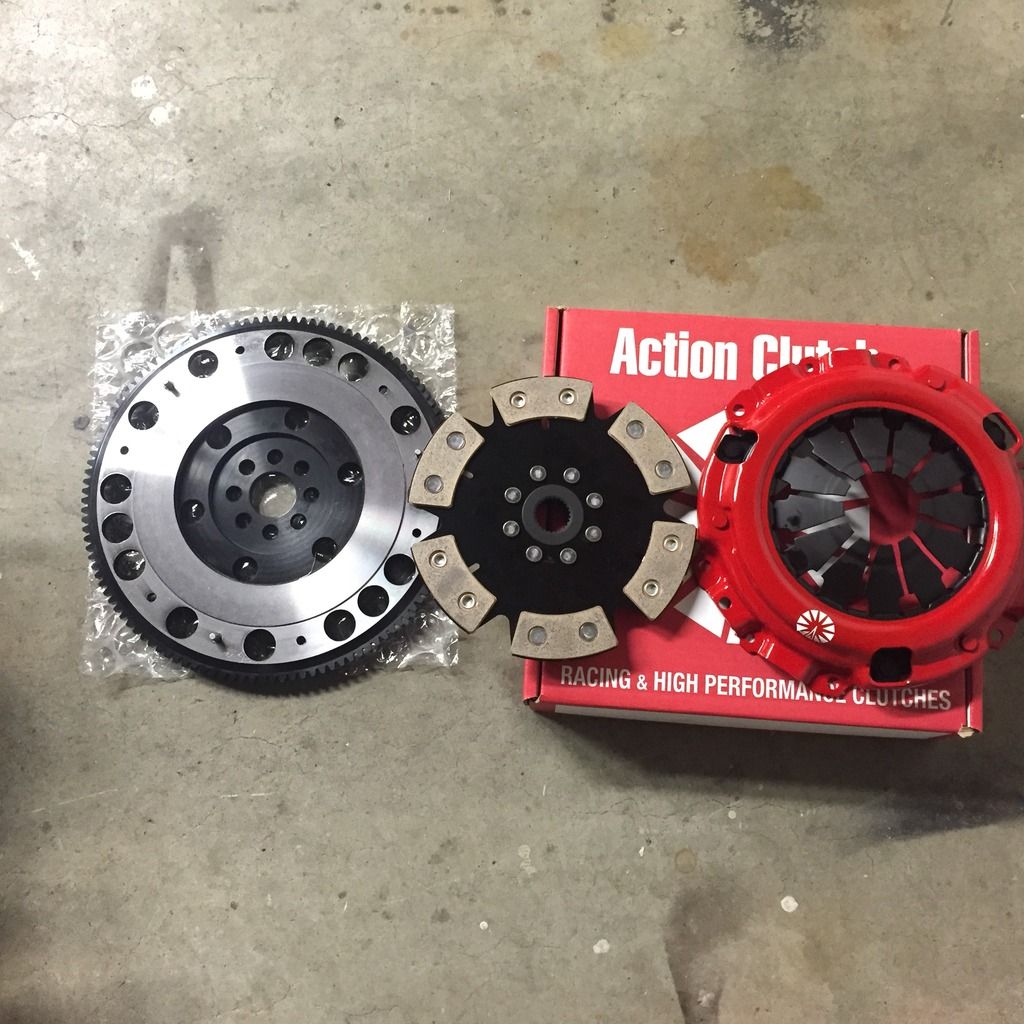

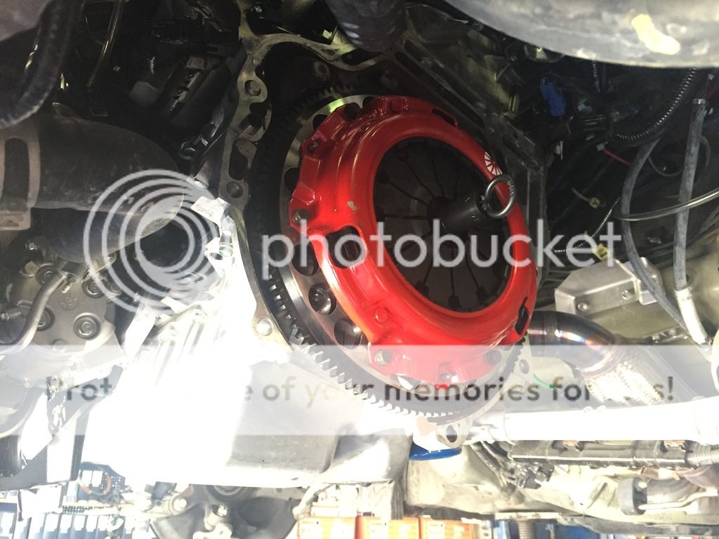

I'm not attacking you in any way but I'm sorry, but the tech has no idea what he's talking about. He simply points to something that's worn out and blames the noise on the wear. Although the springs on our clutches are known to come loose, it's not the cause for the 1st gear noise on takeoff. Just to make sure we're on the same page, here's a video of my sound and we can confirm that it is "that sound":
View: https://www.youtube.com/watch?v=h_6hI4u3Nik
The clutch i'm running in the video is an Action stage 4 unsprung 6 puck clutch with an OEM throwout bearing. Crazy how the springs came loose on that as well huh?
Funny part is, when I had my OEM clutch, it never made that noise. After running my Stage 4 clutch + a new OEM throwout bearing for a few thousand miles, the noise came up.
Problem completely went away after I switched to an aftermarket throwout bearing, and has been noise free for the past 4000 or so miles.
Tl;dr
Oem clutch == No noise
Stage 4 unsprung clutch with OEM throwout bearing == 1st gear noise
Stage 4 clutch (same clutch) with aftermarket throwout bearing == No noise

First I've seen anyone take the time to put together the evidence for the throw out bearing being the culprit. Just wish you would post about it where it was being talked about instead of dragging things here and talking down to everyone in your 1st post on this forum, ever. Also, your photo links are dead. Thanks though, it's nice to see someone put in the effort.
