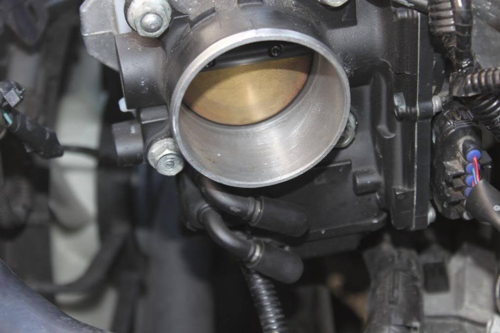

I forgot, I have pics of my coolant delete. I used 5/16" vacuum caps.
I capped the tb connections:
Top coolant connection:
Bottom coolant connection:
A slightly zoomed out picture(s) would be great to get some perspective in relation to where these locations are in general.
Sure. I'll try to get some pics for you.
I would like to do this, but it would definitely have to be reversible due to cold winters.
I'm sure it's simple to switch back. You're probably going to lose like a couple fluid oz of coolant. But that's about it.
The connections capped are circled in red. There are two connections on the tb. The rubber vacuum caps were less than $3 shipped when I bought them. Now they are going for $7 shipped...
