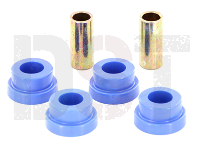

I found a better material bushing for my GSP arms. It is relatively close to polyurethane in terms of material property. I'll be able to use the existing GSP sleeves for these bushings as well. I think this will only fit the one end of the arms bc these bushings will be too thick for the other end (chassis side). These are available in black and blue. Of course I took the blue ones.
These are also much much better than the MOOG bushings.
Not hard at all. You can use a flat head screw driver to pry out the old bushings and use a work bench clamp to put the new ones in, as well as the sleeve. If you have the washers, you're golden. I'm just trying out different bushing materials bc I can't help it. :giggle:

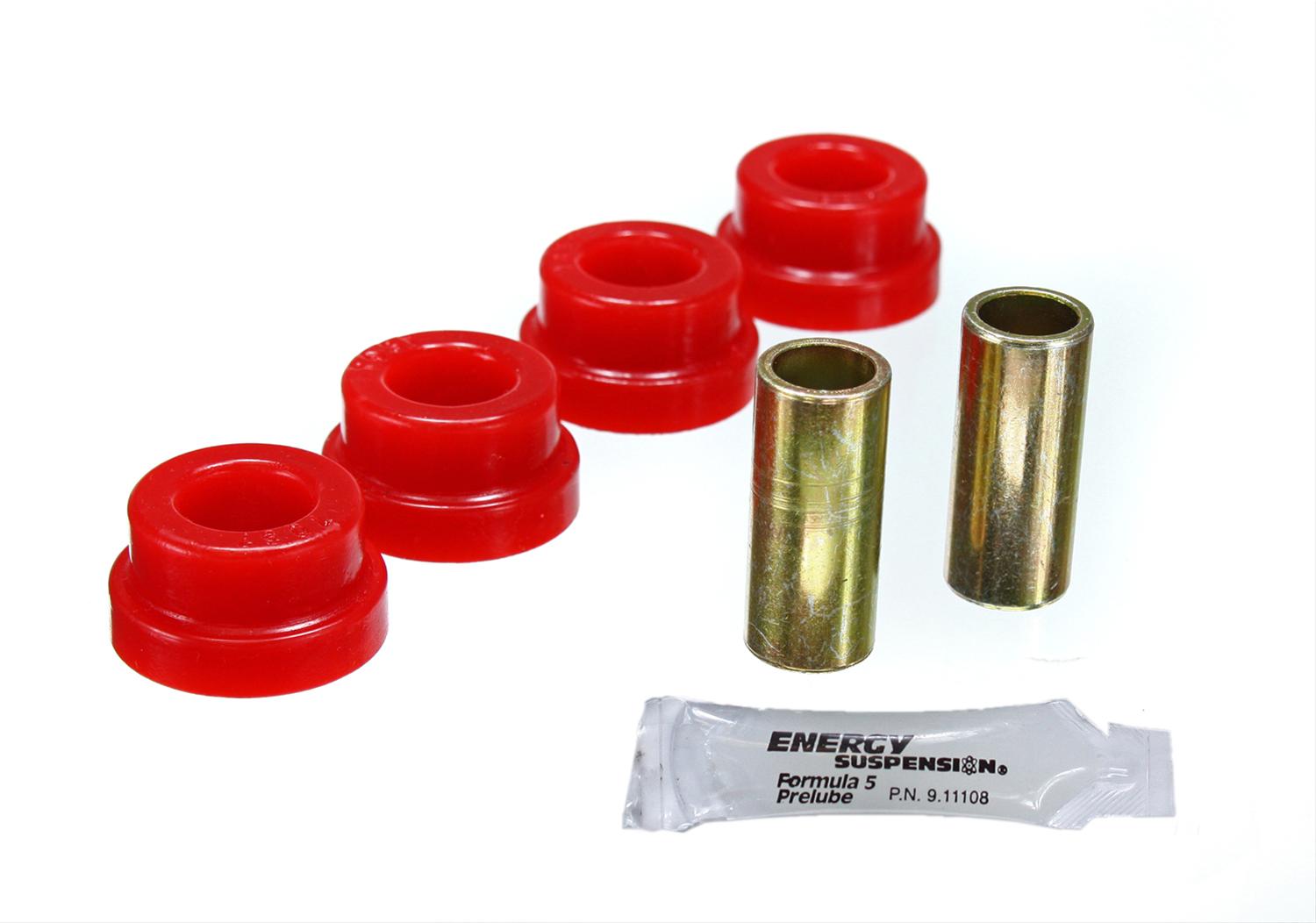

These bushings are used for 1988-1998 Ford F-Superduty and 1985-1998 F-350. I want to confirm that the ones I have fit before you guys start buying these. The ones I have are being sold by MOOG. But the red ones should be just as good and are about half the price. The sleeves in these kits are too small. You can use the GSP ones.
http://www.moog-suspension-parts.co...ame&Sec=3997&gclid=CL2GmoPdvroCFQif4AodwDkAEw
http://www.summitracing.com/parts/ens-4-7115r?seid=srese1&gclid=CJ-DwcvcvroCFYSd4AodkF4AVw
Again. Wait for a confirmation before you guys start buying these.
I did a test fit last Friday. These bushings were getting over compressed and were a few millimeters too wide. However, they can be shaved using a Dremel tool using a sanding bit. I'll try to shave off 1mm per bushing and see if that will work.
