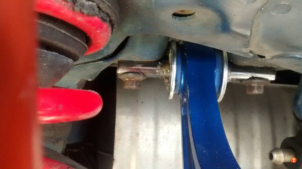

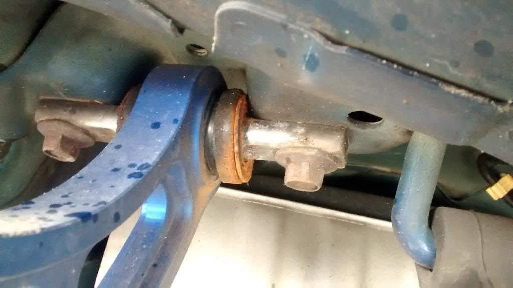

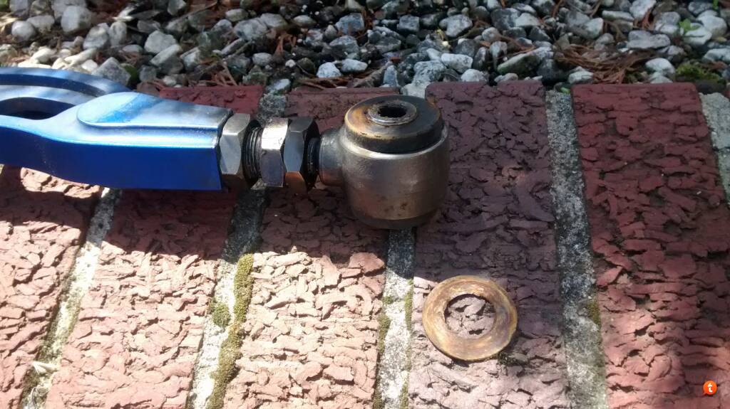

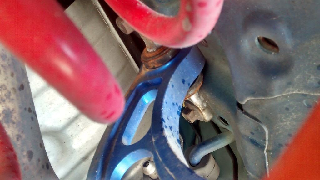

**UPDATE** More problems
After one winter season, I went to check the cambers arms. A c-clip rusted and broke off. Godspeed did not coat the c-clips with zinc which is why they corroded very quickly.
The other side shows the rusted c-clip but it is still in tact.
I'll be in the market for better camber arms. Sorry to say guys, but these camber arms are pure garbage. I only had these arms since last March 2013 so it's only been a little over one year...

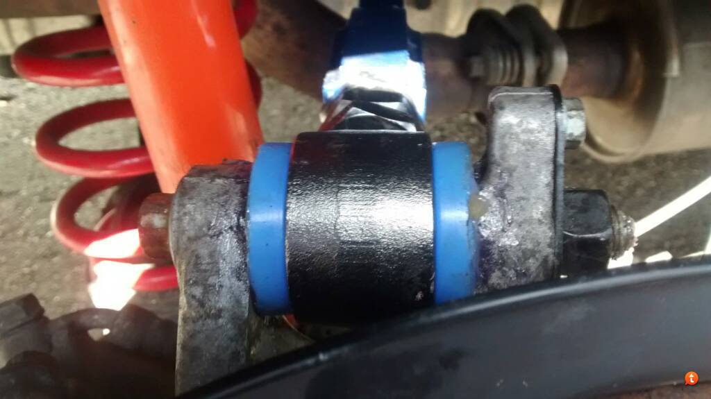

These bushings are used for 1988-1998 Ford F-Superduty and 1985-1998 F-350. I want to confirm that the ones I have fit before you guys start buying these. The ones I have are being sold by MOOG. But the red ones should be just as good and are about half the price. The sleeves in these kits are too small. You can use the GSP ones.
http://www.moog-suspension-parts.co...ame&Sec=3997&gclid=CL2GmoPdvroCFQif4AodwDkAEw
http://www.summitracing.com/parts/ens-4-7115r?seid=srese1&gclid=CJ-DwcvcvroCFYSd4AodkF4AVw
Again. Wait for a confirmation before you guys start buying these.
Now I'm forced to do this. The bushings won't fit exactly, they'll need to be cut and sanded down for the best fit. It will be another small project. At least I still have some extra camber arm parts laying around. I just need to buy a die grinding kit, c-clips, and a caliper. Lol.
