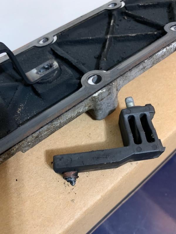

Another day another diesel ram with the cab off for a new engine. This is the 2500 that ate the bolt. Been sitting on my hoist for weeks.
"ate the bolt"?
grid-heat-2-jpg.839125
grid heater fails and drops a bolt into the intake, bolt rolls into cylinder 6. piston eats bolt.
Is this a common thing? Will it just end up happening again with the new engine, or is there an actual “fix”?
I'm not sure. I've seen it a lot on the internet. There's supposed to be a bulletin for the relay sticking causing this issue. Co worker just replaced the grid heater on a other truck for a grid heater code but it wasn't loose. Lots of stuff on the internet replace this stuff with an upgraded banks intake that removes the heater and relocates it.

Yeah. The intake is a ramp so it rolls down to the last cylinder.
