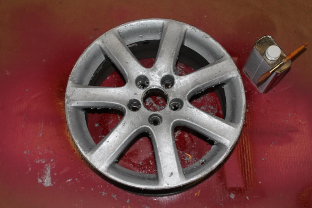

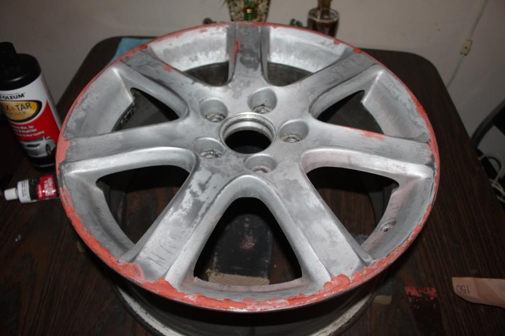

Im working on two wheels at a time. One has the paint stripped and getting the curb rashes filled. And the other is getting paint stripped.
I'll resand the wheels with 150 grit before priming.
I want to get these done quick so I can mount the winter tires before the next snowfall.
What are you using to strip the paint?
Rustoleum Auto Stripper. It comes in a can like the one shown in the 2nd pic. You'll find one on Autozone or any auto parts store. When you use this, try to pour the paint stripper on a metallic container since it will eat through any other material, like plastic. Lol. What I do is just dip the paint brush in the can since Im too lazy. :giggle: It gives a burning feeling when it touched my skin. Rinsing with cold water helps.
