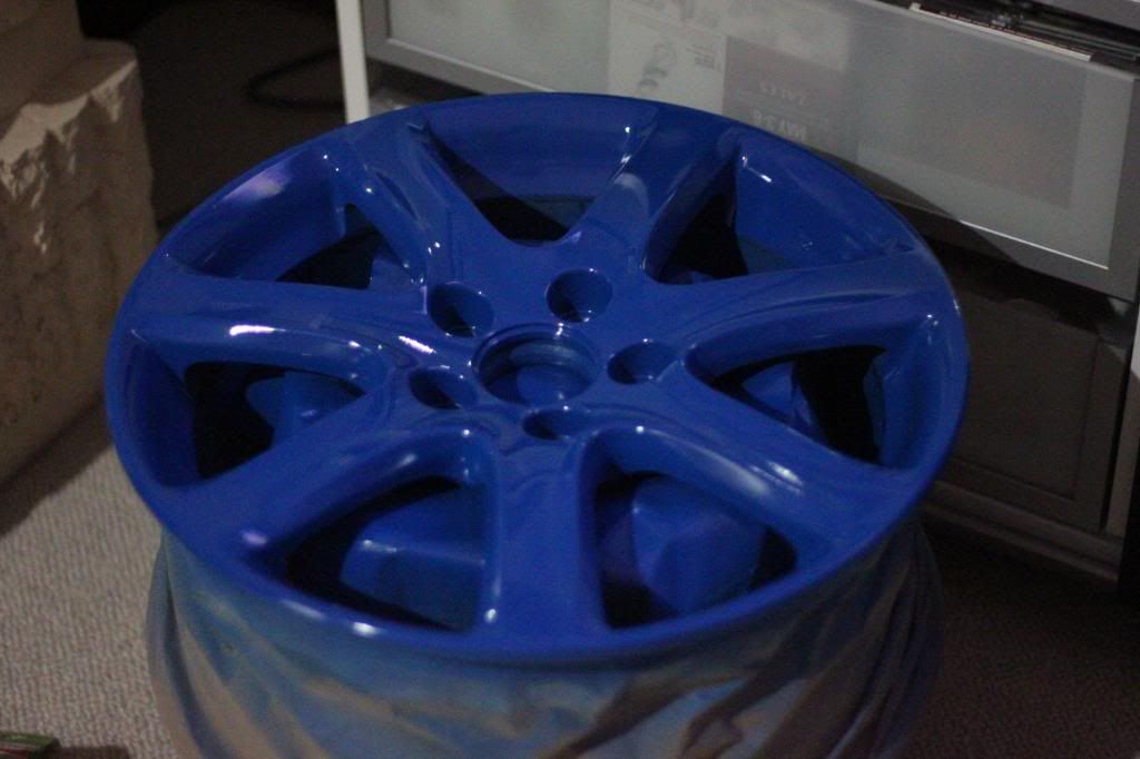

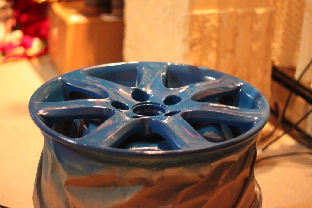

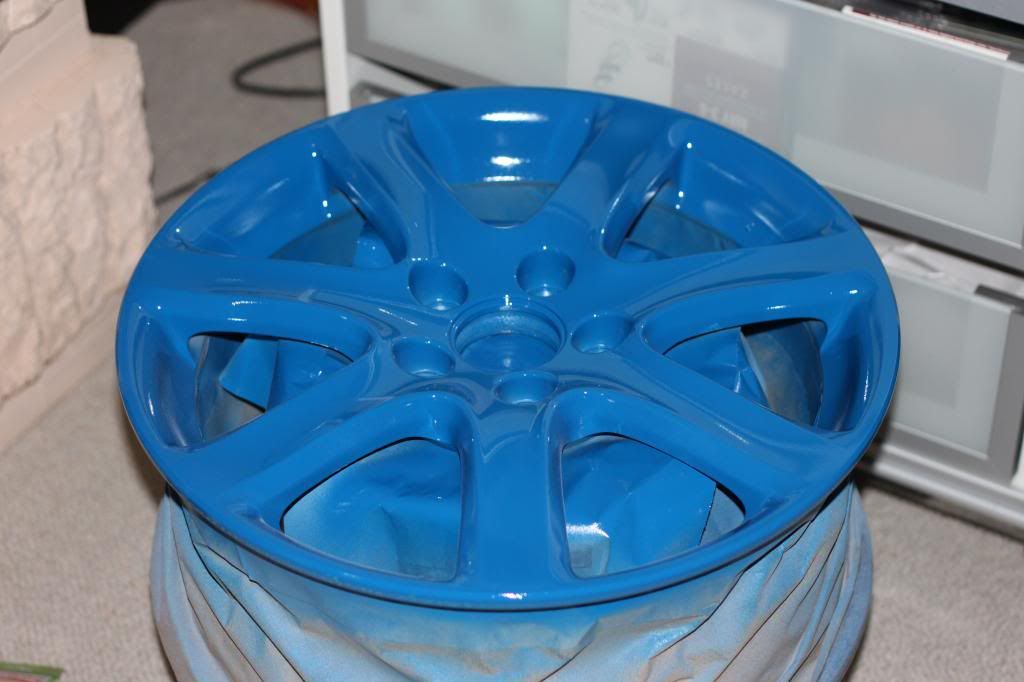

I used a 150 grit to remove the remaining paint from the non-stripped surface. Then 500 on bare metal. Then 500 again after priming. I didn't want to go a step finer since these wheels are only for winter so I don't want to put too much effort.I was planning on just putting the snow tires without fixing the curb rashes, but that would have made it an eyesore. Here's another pic after 4 coats of clear.
I really like it too. This is the same paint I used for my valve cover. The paint gives distinct blue shades depending on the lighting.I really like that color

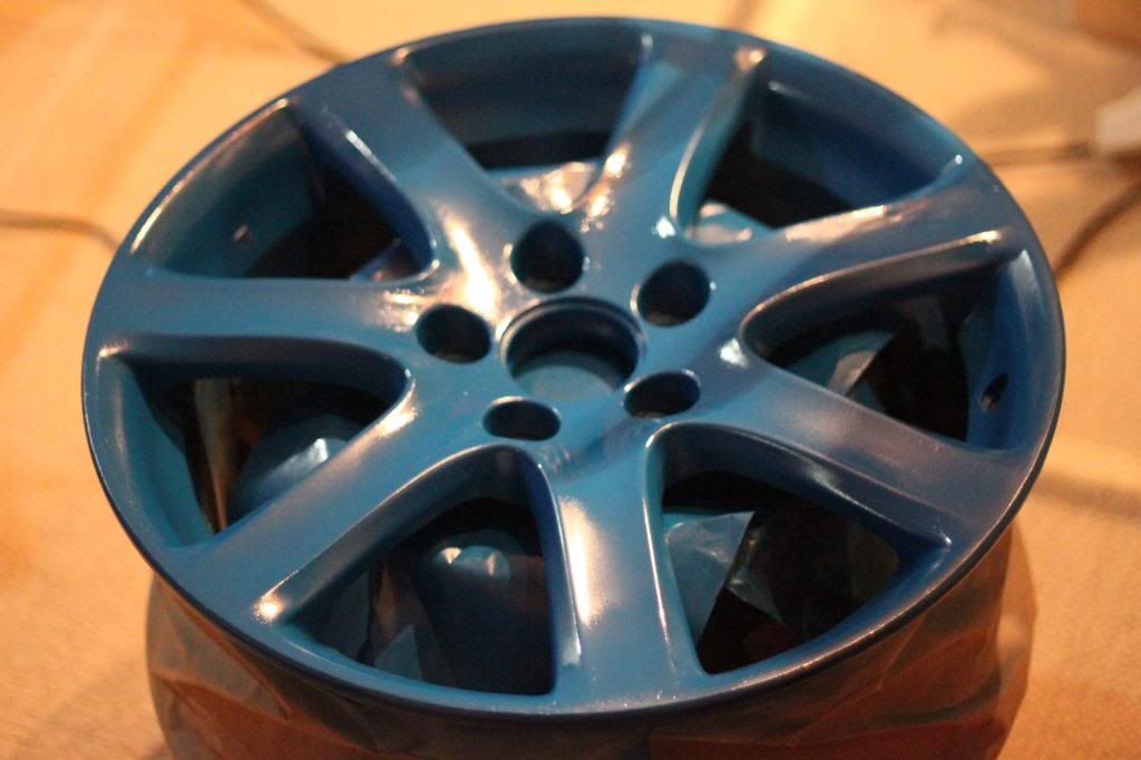

This one is the second wheel btw. The paint I used is Ford Light Blue Enamel.

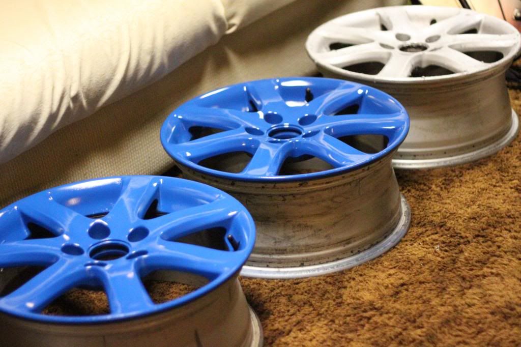

The light color will only be noticed when the wheels are right under the sun. I'll get these installed when I get the winter tires mounted or the day before the next snowfall. Lol. I installed new valve stems on the painted wheels. I didn't realize they are $2.99 per pair. They are rather cheap.the lighter one looks pretty good, post pics of them on
Lookin nice dar dar maybe u can help me with mine sometimeThe light color will only be noticed when the wheels are right under the sun. I'll get these installed when I get the winter tires mounted or the day before the next snowfall. Lol. I installed new valve stems on the painted wheels. I didn't realize they are $2.99 per pair. They are rather cheap.

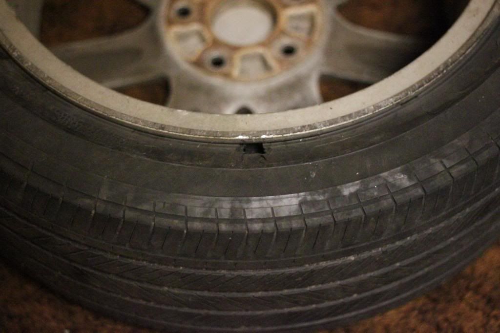

One wheel still has a tire on it. I tried removing the tire without damaging it but the tire is dry rotted and the tire bar broke the sidewall. Lol.

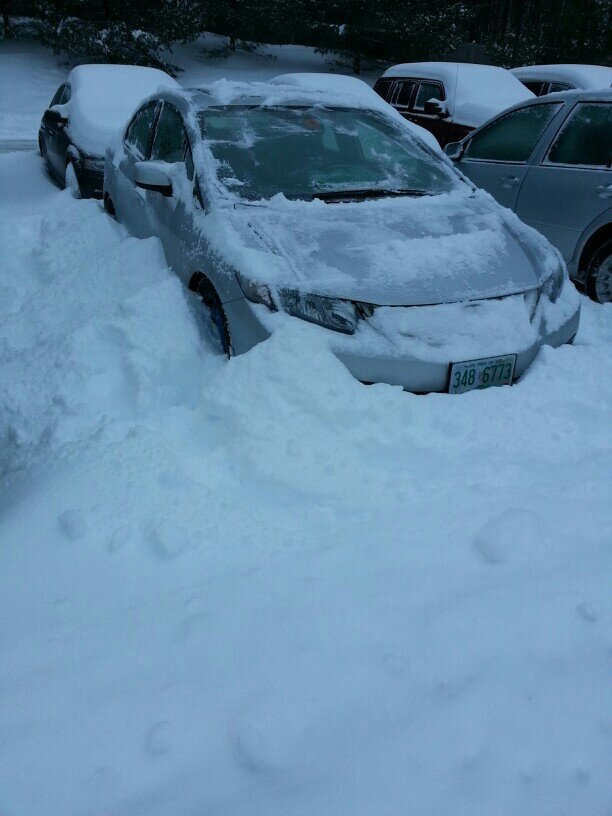

Snow plowed with it![]()
Same here, was out shopping last night rally driving around.Lol. I went out and had some fun in the fluffy snow last night, it was great! If only Civics came AWD![]()
