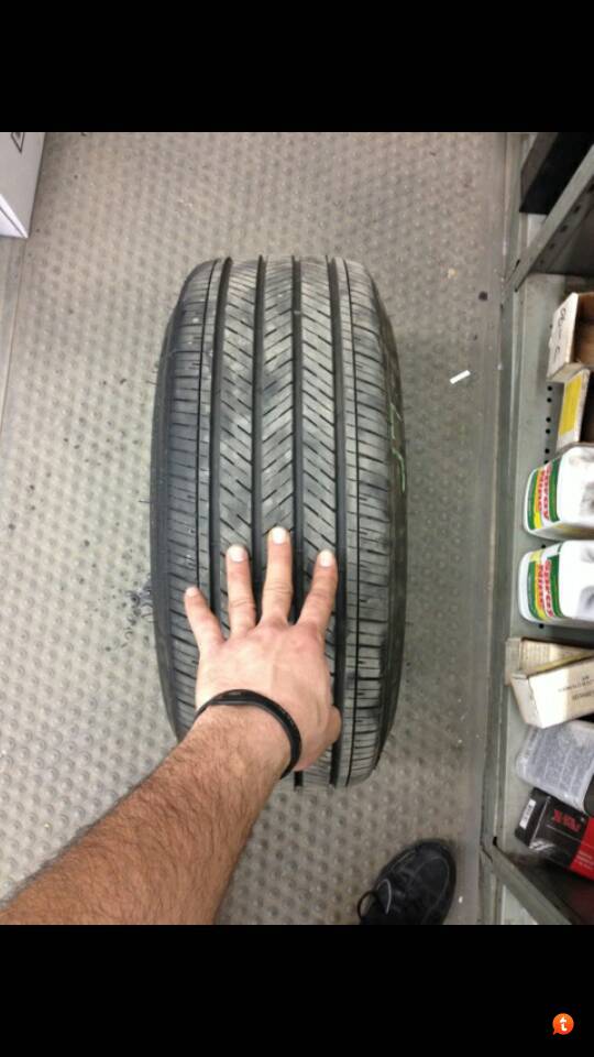

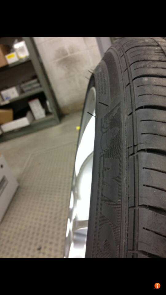

give me a second ill post up pics of stock 215's on an 8 inch wide wheel maybe one of the mods can edit the first post
Probably.. I wouldn't call it very mild but it varies some 215's fit wide as I've seen but stock for sure is mild
