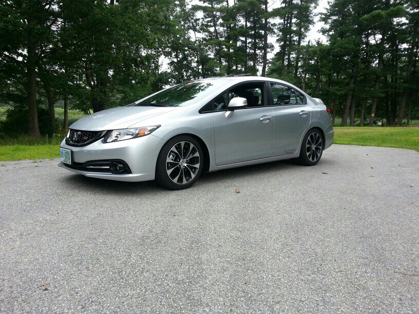

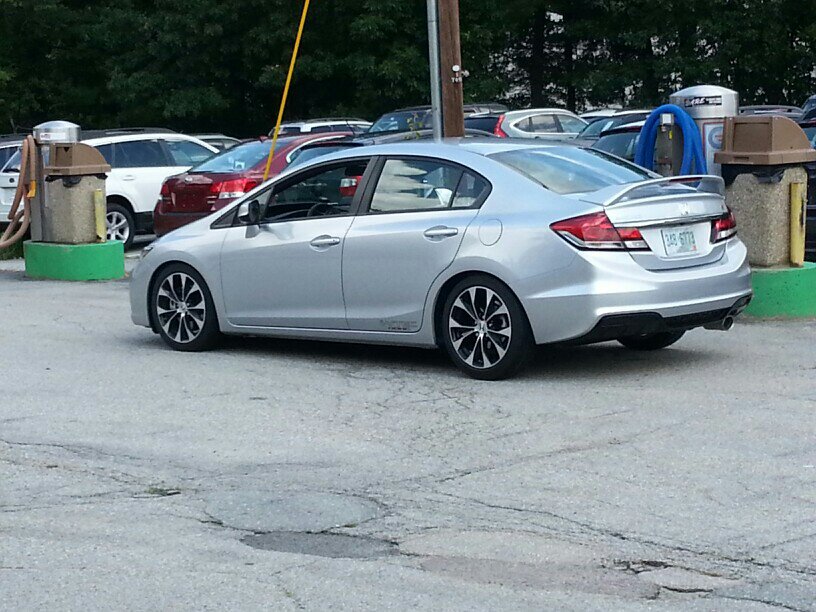

The drop rate the H&Rs give is exactly what I expected. My fenders sit at about the top of the tires. I'm running 17x7 wheels with a 205/50 tire (only because they came with the wheels with a decent amount of tread left). Once I switch wheels for the season I'll be getting 215/45s. Here's how my car sits (not the best picture to show a drop, but it's all I have for now):
i definitely like the drop of the sportlines. im just scared of bumps because i sit flush in the front with a minor stretch, as for the H&R ur 205/50 tire is 25.1 inches in diameter as opposed to the 24.6 i have from the factory so the gap is slightly closed but its hard to see with the shadow. if you would be about to get a better picture that would be great!
