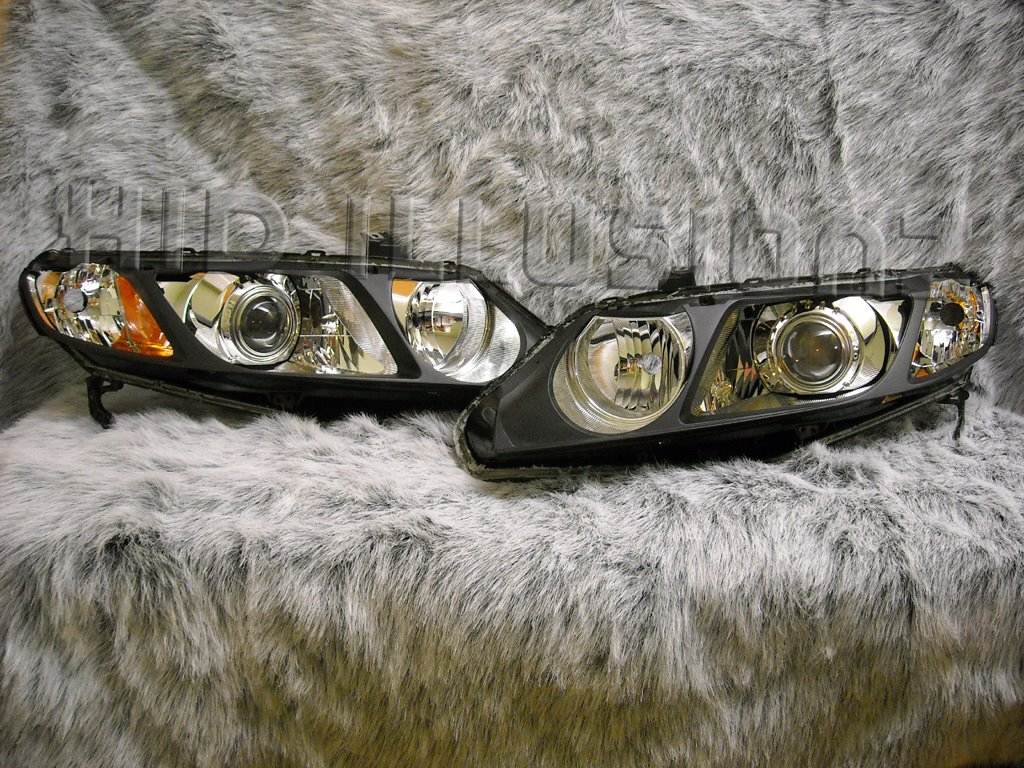

How would these work with S2k or Rx 330? Which should I go with! I the s2k are great but are they really worth it?
to be honest, i prefer the output of the rx330 over the s2k. S2ks bend downward so even though they have a pretty wide beam you lose usable light. Rx330s can be tweaked with clear lenses and modded shields to get better output than a s2k.
ive got modded rx330s on my car and love them

doing the retro in a day is tough, ive done it once before, but you really need to give the adhesives at least overnight to finish outgassing before you seal things up
Probably start early, and if you have a garage we could work at your place start early, let things outgass till later or the next day then close up. Having never done a 9th gen id need to test aim on the car so a garage or somewhere to see the light output during the day would be vital.
rx330s go for 150-200 i think
e30 lenses should still be going for 40
shrouds can be 50-100 depending on what you get and where you find them
I use bolts and springs from a hardware store to do most of the mounting about 20 dollars in hardware

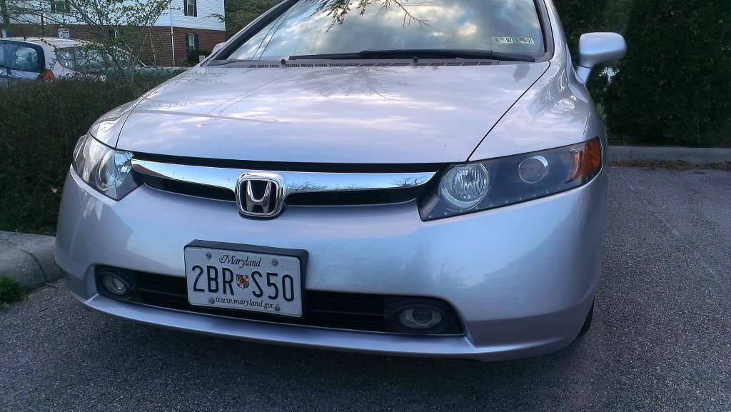

Oh ok. I just sometimes worry if I'm getting what I ordered. That's the only think I'm worried about. You like the wiring harness and that stuff I had a issue with my retros on my 8thgen and I don't want to go that road again.theres not really anything wrong with buying from TRS, you do pay a premium for getting it from them vs searching ebay on your own, i dont know how many deals are out there on ebay anymore though since people like TRS buy everything up.
ive seen the TRS wire harnesses, theyre pretty well built, i can build or modify cheap harnesses too if necessary.
with the exception of the fog retros ive done all the work on my car myself.
