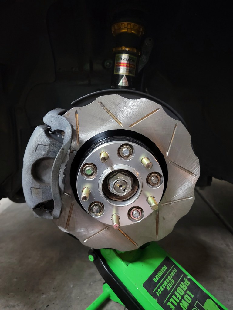

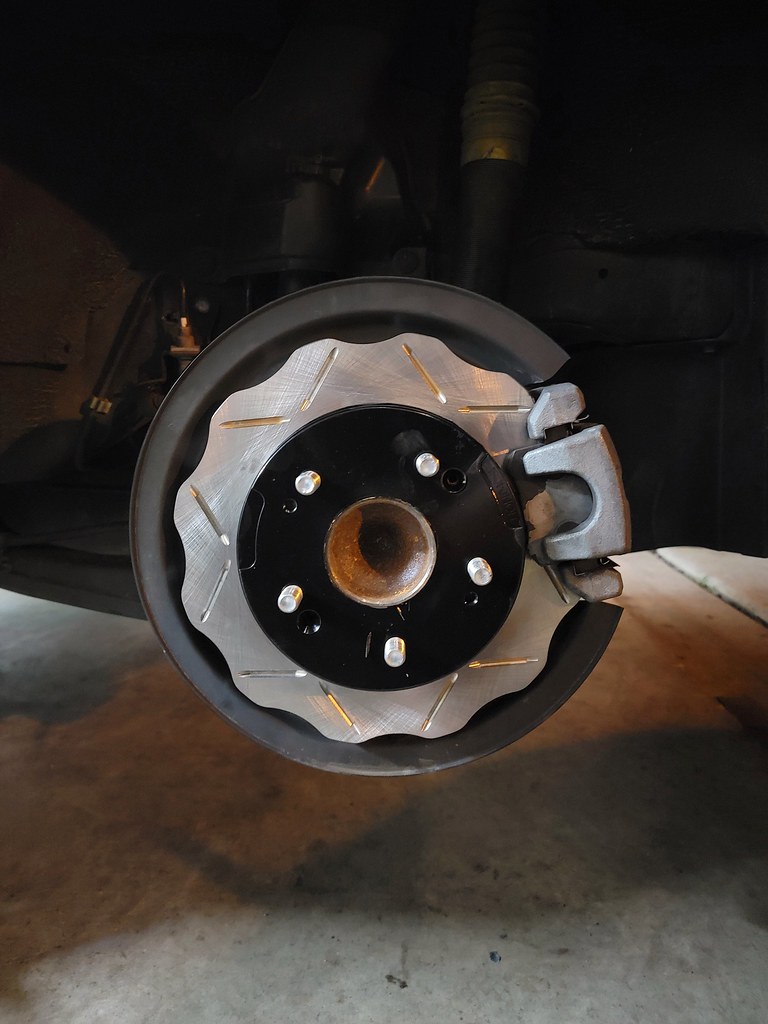

So while I wait for the 20mm spacers to show up (literally one of the last pieces to show up) I thought I would be proactive and paint the rotor hats on the Wavespec's to help with rust prevention. Im kinda leaning towards the teal that Project Mu uses or maybe a color similar to Spoon brake calipers. The way Im gonna do this is with high temp primer, the teal/blue color with some sort of metalizer look/flake, and then clearing it with high temp clear and then painting the vented edge in black. I think it should look pretty sick once completed.

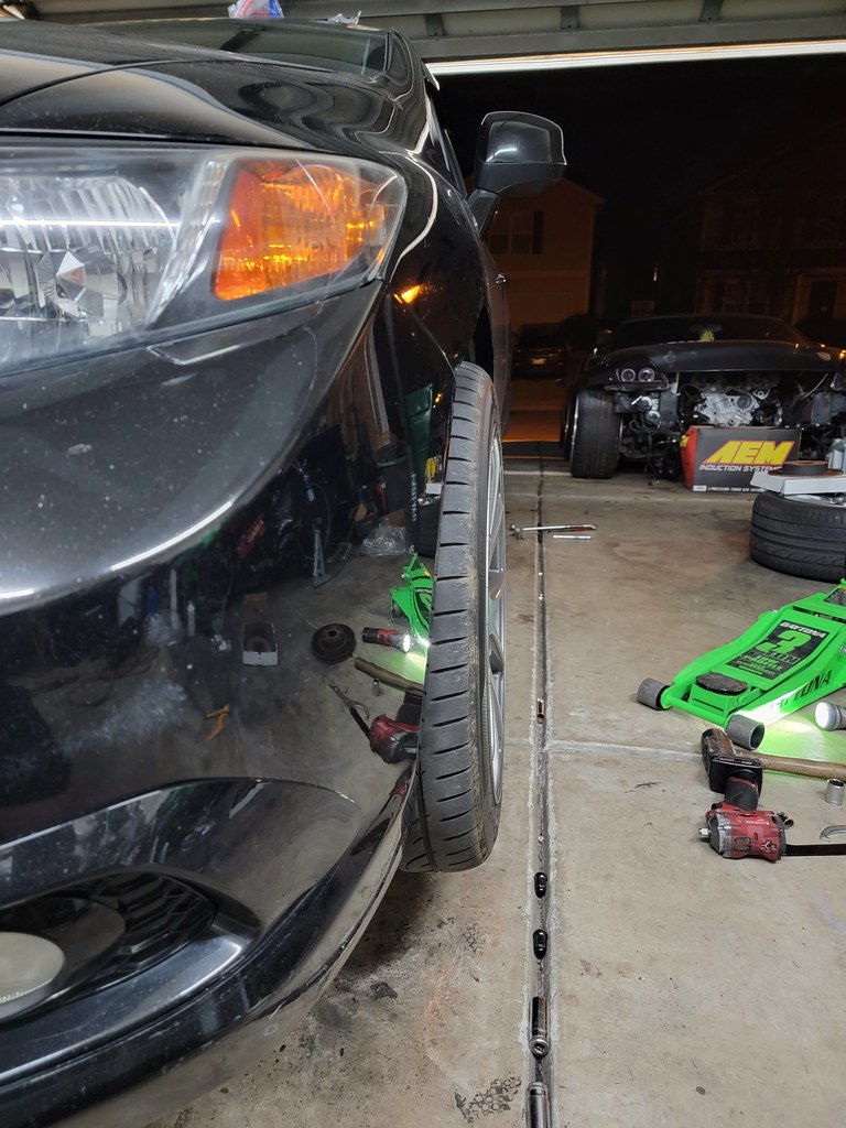

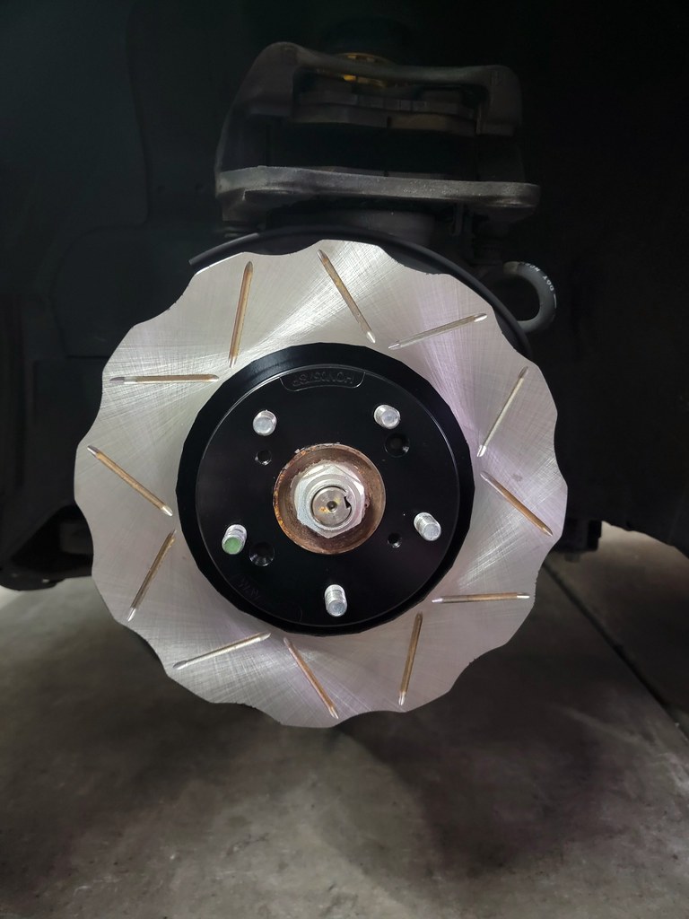

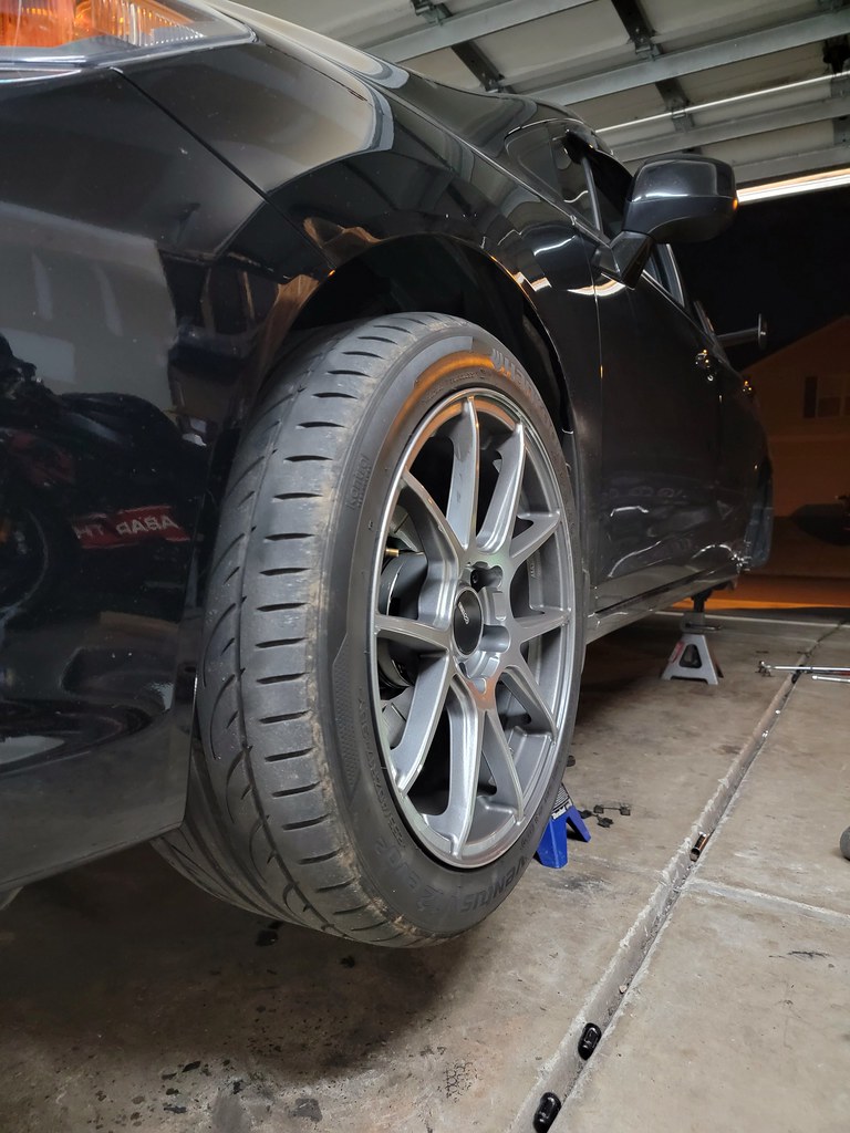

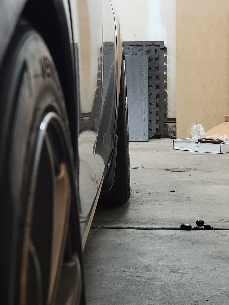

Got all my most recent parts installed tonight. Did the Wavespec rotors, camber bolts, and spacers. I wish I had brought one of the Hypergrams with me but I kinda forgot. I ended up raising the front up .5" and adding maybe another degree of negative camber. Camber plates are not maxed out but Im hoping to run at least -3.5 degrees which should get the 660s to fit better.
I couldnt find the teal color I was looking for so I did them in black.

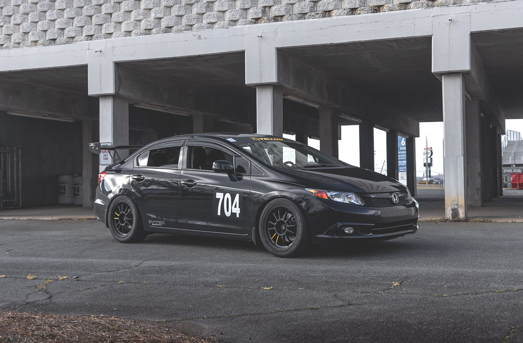

I dont remember what day it was but I maxed out the top hats and then had an alignment done on the car the other day. Final numbers are -3.8 degrees front, -3.0 degrees rear, and zeroed out the toe for the front and rear because this is still a daily driver. It rides great but I am still gonna have the front fenders pulled a little bit

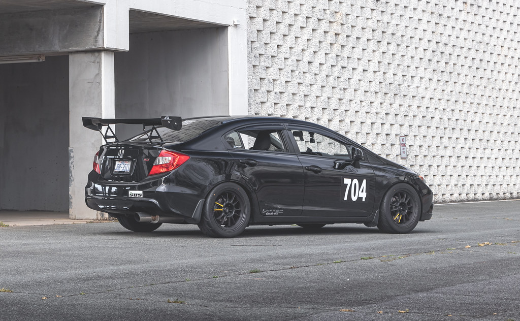

So Hyperfest was awesome as always, except it felt weird not to be running around doing media coverage so I kinda found myself meandering around the campground. Drove up from Charlotte, which is about a 2.25 hour drive, Friday mid morning. Had to make sure I got a good spot but unfortunately there werent a whole lot of spots available in the paddock so I found a nice grassy spot behind the Konig Wheels booth. I took the rest of the day Friday to snap some pictures of the events going on (I have more I just need to edit them)
Saturday was the started off super wet with a downpour that lasted about two hours. So my first ever VIR track session was in the rain...it was a little sketchy with some areas of the track turned into wading pools. Managed a time of 2:59. Second session was the first dry session and I managed to learn the track a little bit more and got a time of 2:41. The 3rd session got a little weird. For some reason as I am doing my warm up lap the ABS and VSC lights popped on along with power steering. I stopped in the pits and turned the car off to see if the lights would just go away but they didnt, which made me a little worried about not having ABS for the remainder of the session. I still managed a time of 2:44 and Im thinking that I may have broken and ABS sensor hitting some of the curbing on track but I havent checked yet. 4th session was my first solo session and not having an additional 200 lbs +/- of instructor weight surely made a difference as I was able to get a new PB of 2.38.125

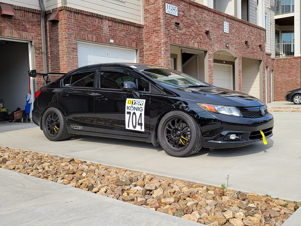

As far as updates on the build the last two wheels from Konig arrived today and i dropped them off at the powder coating place. After getting multiple quotes for paint work, it was roughly the same price to get them powder coated and is usually more durable than paint. For the color I am still doing blue but I am in between gloss or matte blue gunmetal. Its difficult trying to find examples in the colors I want. I purchased new tires for those wheels as well and went with the Falken Pro G5 A/S in 245/40/17. Its gonna be nice to drive on a much more daily-able setup than these 660s.

I also got my Konigs back and they LOOK AMAZING. Exactly the color I was looking for!
