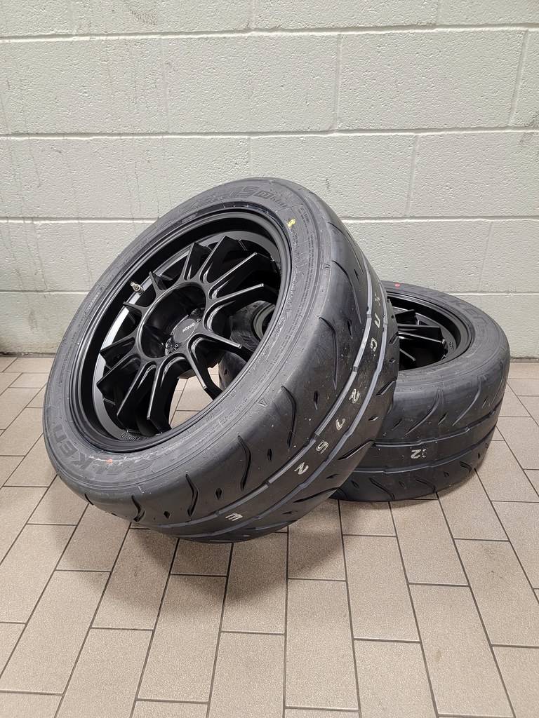

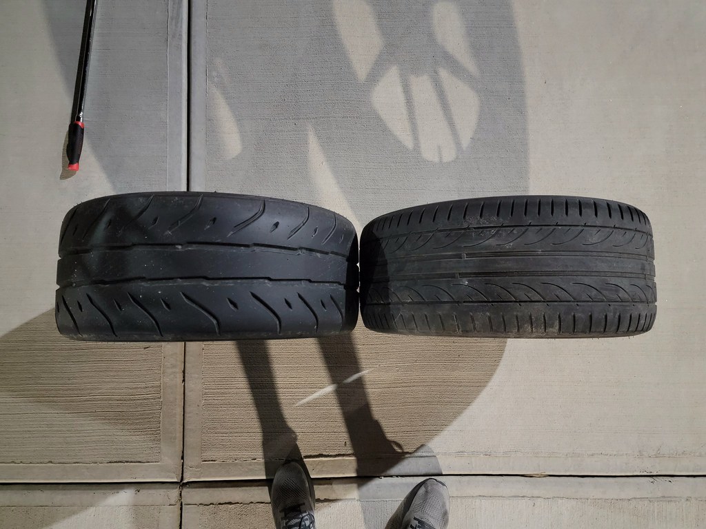

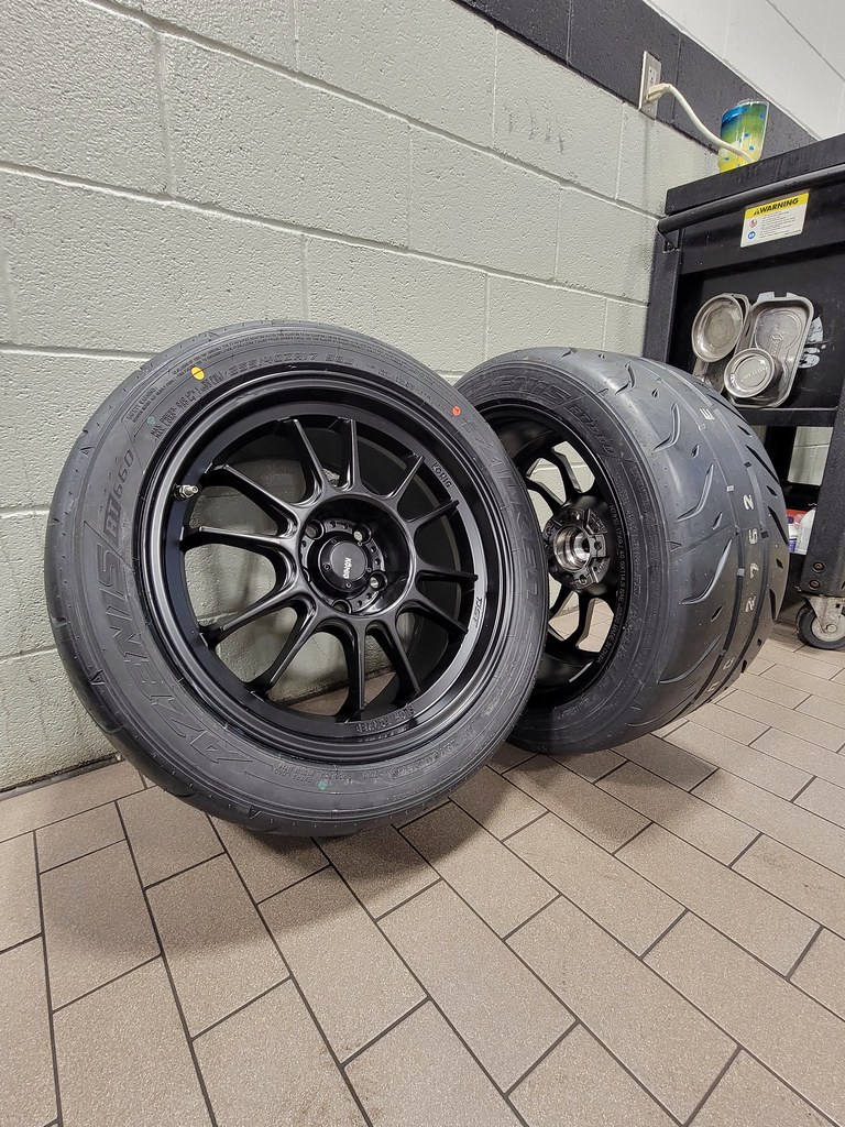

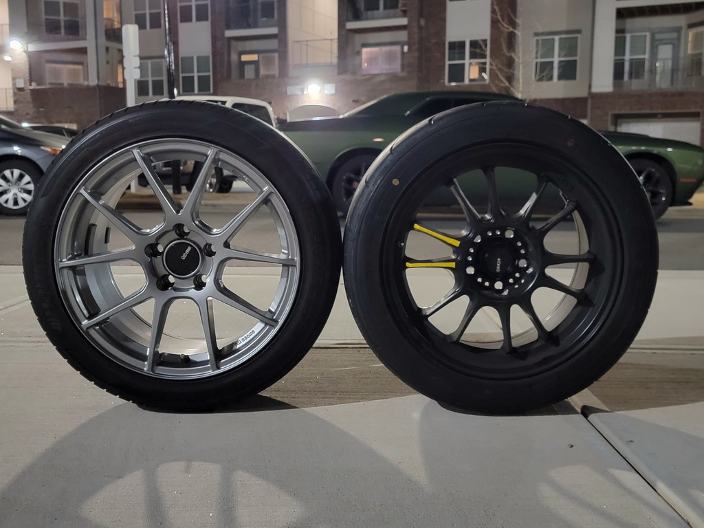

Did you happen to weigh the wheels before installing tires?

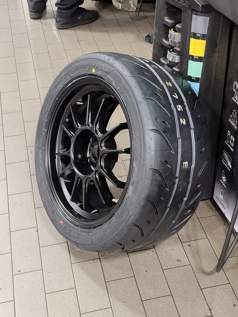

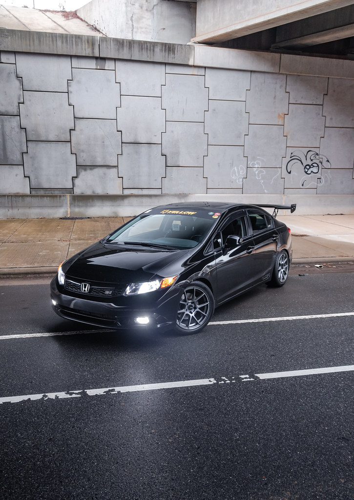

Threw the new wheels on. The 3mm spacers I got did nothing so my buddy gave me his 5mm and it left about a finger gap of space between the wheel and coilover. They still rub slightly, especially on hard dips so Im probably gonna raise the front .5" and add a second camber bolt on both sides to get more camber adjustment. Im at around negative 2.3 and need to be around negative 3.5. I also need to order extended studs for the front only.

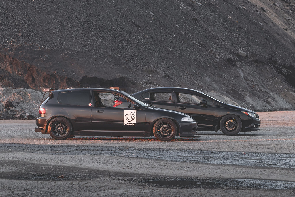

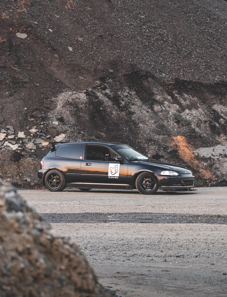

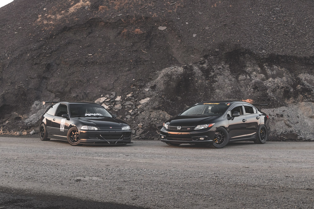

There were a few events going on yesterday and then afterwards I got up with my friend Alex to get some pics of his EG Hatch.

Alrighty, so the 5mm spacer arent working so its back to the drawing board. I need to run -3.5 degrees of camber to get the most out of my car up front and right now the wheels are gonna rub the springs. A lot of the track guys are saying 17x9 +12 - 25 is the ideal offset to pull this off so Im gonna order a 15mm bolt on spacer to push my offset to 25mm and maybe raise the front .5". Its crazy just how much of a change a few mm in tire construction does to your whole setup.
