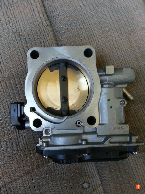

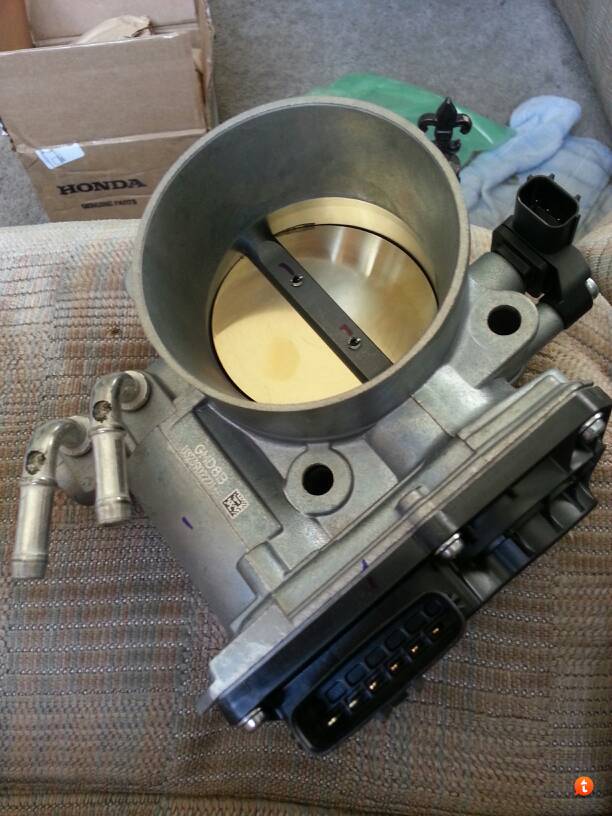

So today I said F-it and sent payment for the zdx tb so no more idling problems anymore and it was getting warm so they were gonna go away but i wanted to have no more idling problems. cant wait for it to get here. gonna be selling the skunk2 when i get it off and give it a good cleaning. OEMFTMFW

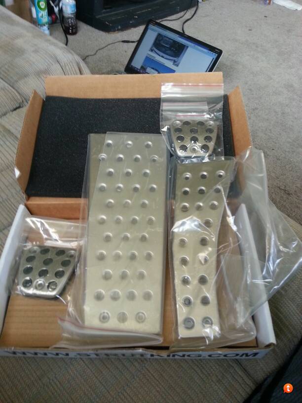

Strutking pedals for the 8th gen civic finally exchanged for the 9thcivic 12 days of Christmas win

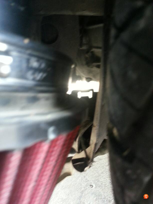

Installed my fender liner and the cold air intake tube and with the new bigger filter and velocity stack it just barely fit and I have like 1"-1.5" of clearance from the wheel when turning.

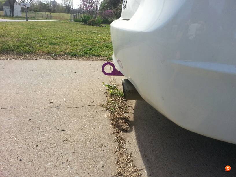

And then I installed my yospeed towhook I got for winning the 12 days of Christmas on 9th civic.

So I test drove a orange 2014 sedan si. I ******* love the interior but I feel like the red and black seats clash with the orange paint. But absolutely love interior with the back up camera and lane switch camera. Im really debating on picking up one. On a side note I GOT MY ZDX TB!!
The 2014 orange fire pearl is a really unique and nice color ill grab a pic in a little bit of it im thinking im gonna save for a down payment so my build will be put on hold kinda, and I might do a little part out of my current car. But will not trade in, maybe sell the rrc and skunk 2 throttle body and sell my tsx cams when I get the go power cams in and sell wheels and go to a stock wheel, and any thing else i dont want.
Im having the zdx bored out and maybe my rrc ive contacted this guy who can do a amazing job hopefully he will get back with me soon. And not have a outrageous price.
So im sending my zdx tb out to maxbore like this next week to be bored out to a 73mm will also need my throttle body spacer portmatched. Then to sell my skunk2 tb. I want to have my rrc bored and shaved and powdercoated but I dont know who to have port and shave it. Any suggestions? That guy never got back with me.
So my previous is job being a little punk and hasnt givin me my last paycheck. And its been almost a month. So when that comes im getting a valvetrain. Tomorrow im just going up in there and demanding it. So hopefully ill get it ordered soon, then valves and to send my tbs and zdx tb sent to maxbore. So excited ready to get these cams in my car.
