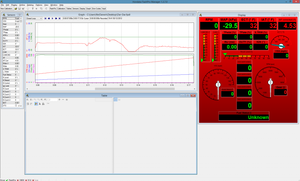

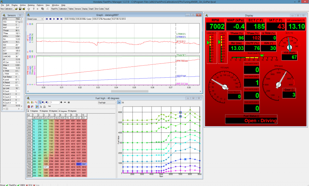

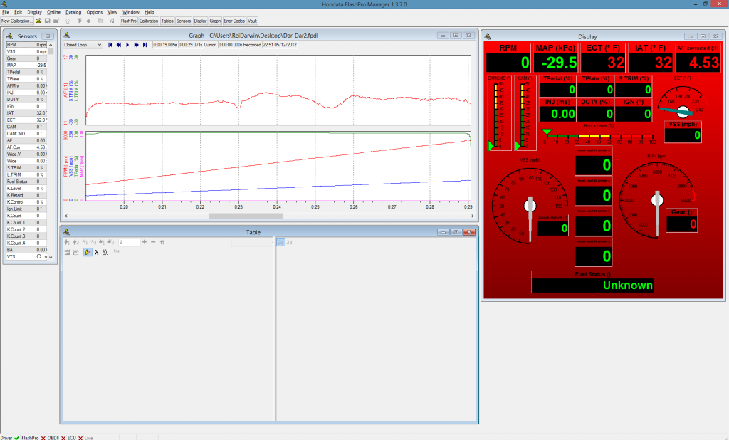

Did a few datalogs and some tweaks using the flashpro for my 07 Civic Si yesterday. All the pulls were from using 3rd gear.
1st run: The A/F ratios were really bad. Lol.
2nd run after some changes: It's looking great!
3rd run: The line is getting much flatter!It's getting smoother but it got a tad bit leaner before the V-tek crossover. So I'll make some changes. And hopefully on the next run, I get to hit the right a/f.
It's also hard to tune the car when I'm using my 15" laptop for street tuning. I'll save up for a net book. Maybe the Acer Inspire One. I heard great things about it.
This is pretty much fuel management and used for maintaining a constant or a target a/f ratio of 13.1 for a 3rd gear WOT load. The car will have a decrease in efficiency when the fuel mixture runs rich and fuel will also get wasted. You can see on my 1st screen shot that the a/f drops way too much and reaches 10.XX to a steady 12.2-12.3ish on the higher RPMs. I also did this to look for lean mixtures. I don't want to risk the engine to blow up. Lol. The a/f is much better on the 3rd screen shot. But some parts are a tad bit leaner than the target ratio. That small 'ditch' that you see if coming from the v-tek crossover. I'm not sure if that's normal or not. But I assume it is. On the bottom line, the whole purpose of this is to keep a steady, or close to constant, air-to-fuel mixture to get a smoother running engine without losing efficiency and wasting unused fuel. This is also useful for a person with flashpro on his/her car before dyno tuning.
