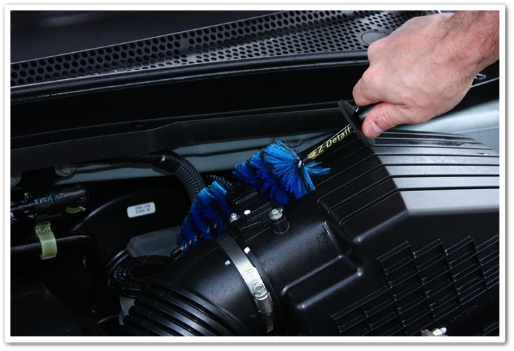

Brush: EZ detail mini is a nice size for the engine bay.
http://www.detailedimage.com/DI-Brushes-M51/E-Z-Detail-Brush-P273/Mini-Size-S2/

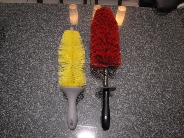

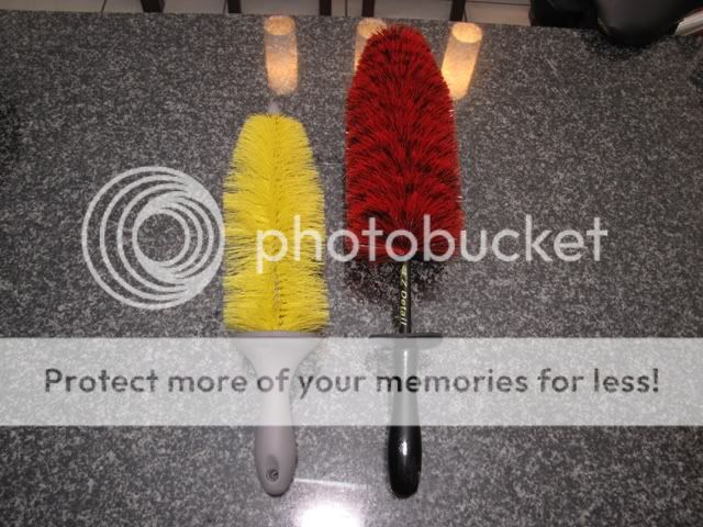

For wheel/all purpose brushes there are the E-Z detail brushes and another company called Daytona
They are the same brushes from what I can tell. One is red one is blue. I believe the blue E-Z brushes are slightly softer. I've seen both names on both brushes so it just depends really. Autogeek.net generally has the red "Daytona" brushes.
http://www.autogeek.net/ezdebrfca.html
Comparison:
attachment.php
Generic wheel brush next to the "Daytona" with "EZ" stamped right on the handle.
Mini brush is just the right size for engine bay and exhaust cleaning.
